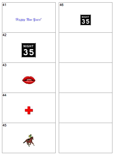

Horizontal and Vertical Photo Browser [Finished-FM 8+]
Solution / : Horizontal and Vertical Photo Browser
Description: A browser that uses portals, and a repeating calc field to simulate vertical and horizontal tiling of photos.
The "photo's" used are just returned from a google search for small clip art images.

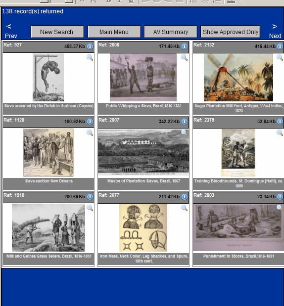

I have looked at using it like a generic search tool. You have a google like search page and then it delivers the results as images. I reduced it to 9 per page and flip per page rather than column. Worked fine until i tested. I found that it populated images in between finds. So if you have results on a find for records 1, 8, 9, 10 It would display images between 1-8 as well in the portal but still have the correct result count which is 4. So did a bit of digging about and found that the calc field c_currentIDSet needs to have the box "Do not evauluate if all referenced fields are empty" unticked. So it resolves the find. This may also solve the delete situation above.
Its a good start and has loads of potenital if you want to whip up a lightbox type image management solution.
Hope that makes some sense.

I am thinking about extending this app a bit. I would like to implement a users selection into another list (in a portal like a shopping basket/lightbox). So the user clicks on the image and it is added to their selection which appears in their basket but you actually see the image.
Any ideas? I would like to have each user have only access to their list.
I await any comments.

Hi Genx,
See my use of your original app for a project I am doing. I am still working at adding a horizontal portal to store a users selections as they add each image to their own list.
There is PHP scripts out there that do this but I think its good to use FM to prove it can do it!
Still. Any advice or pointers let me know.

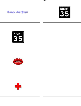

Here are two alt examples taking advantage of FMP9
conditional formating and dynamic portals.
The two left arrows will fade when the first record is reached. (haven't finished the right arrows)
If the portal has autoresize settings on, the nav arrows will compensate.
I have simplified the repeating field relationship with a single field. And removed all nav scripting.
An interesting challenge would be:
-to add your portal paging for the dynamic portals.
-make the logic dynamic enough that nav buttons could pass a simple variable that would control a specific portal, based on object naming.
portalScroll_conditionalFormat.zip
