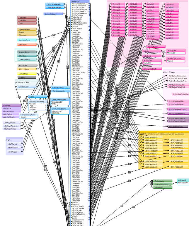

I'm going to get IT to upgrade my PC. When i go into relationship layout it's so slow to navigate around it's ridiculous. Attached is example of my relationships - as soon as I drag a TO it sits there and tries to re-draw everything ack.
I have a Dual Core Pentium 2.8ghz, 500mb of Ram running Windows XP. Stock standard video driver - IT guy argues that upgrading this won't make a difference :)
Your IT guys could be right. My impression (no real studies done) is the FMP gets very slow when refreshing any kind of window that contains a lot of material. Whether this is an FMP problem or a video driver problem I'm not sure but my money is on an FMP problem. It could be RAM but I'd be surprised; I have 1Gb but FMP never uses much of it, certainly not enough to suggest 500Mb might be a problem.

Are you working on the file locally or remotely? I agree with your IT guy too, i work fine on a file with a lot more TO's than that -- 2.7GHz, 1GB ram laptop.
Try breaking the problem down...
Move some of the TOs (the pink group) out of view.
I agree with your IT guy.
I seem to be recognizing what your solution is aiming at, you use a lot of calc'fields as keys for relations that perhaps could borrow the gist of this principle instead:
http://www.fmforums.com/forum/showtopic.php?tid/176396/post/204083/hl//
Think of for a while - that calc'fields are unique to filemaker as application ...and filemaker isn't the sole application to develope a solution in the vicinity of what you want.
We have all in our first solutions made structurally mayhems, only to think just a short while later that something simpler might do! Perhaps you need to reread Harris explanations??
Yeh, just as a general note, your yellow and pink groupings seem repetitive and possibly unecessary -- what exactly is their purpose?
I have to pull the data back to specific field names so I can export that information and merge it into word.
i.e on one side i need to know what date A, date B, and date C equal so when i merge into a letter it says
[We wrote to you on "Date A" and advised you on "Date B". The date of xyz is "Date C"] type thing.
So the other table is just "type" and "date" and on the current it just says if "type" = "A" just pulls back what the LATEST date is of the relationship.
I hope that makes sense (it's a lot more involved than that lol).

Couldn't it be solved a little more transaction'ish by means of say this CF:
http://www.briandunning.com/cf/308
...not something to throw such a web of relations after, to get all represented in one single document for printing, there are alternatively the opertunity to cut up a portal into single lines where each might have it's own set of fields shown and styled.

Soren - I will look into this further. But from what I remember we discounted this due to what we have to get it to do. Tks.
