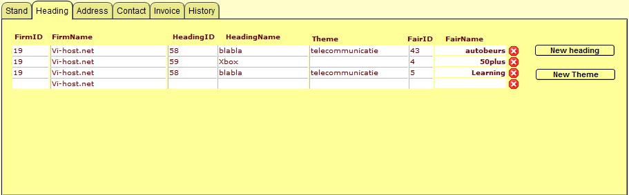

I added a little screenshot of this part of my database. The most important table is FirmTheme (should be named FirmHeading). The firm needs to choose between several Headings. So if firm 3 chooses heading 2 we get:
firmID = 3
headingID = 2
The headings and firms are unique.
What do I want?
That firm 3 cant choose heading 2 anymore when it already has chosen that heading.
Sorry, quite difficult to explain but the solution has to be very simple. I just want that one firm can choose between various headings, but one heading can only be entered once with a certain firm

I just use a portal where a firm can choose theme's. This data is inserted in the firm_theme (should be named firm_heading) table.
My problem now is: I can choose a heading in the portal. But I can choose it more than once. That isn't what it's supposed to do.
So if firm 2 has heading 3 in the table, it cannot be inserted into the table anymore. (only in combination with another firm)
You can choose between validation and a dwindling value list (or both).
The thread I linked to explains how to validate a unique combinations of fields. Using this method, the user CAN choose an existing combination, but it will not pass validation.
A dwindling value list, OTOH, will present only available choices in a drop down list or menu (in your case, only those headings that have not yet been assigned to the current firm). You can find several examples of this method by searching the forums. But it is more difficult to implement - not something I would suggest to a beginner.
