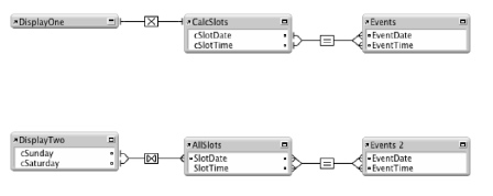

http://www.fmforums.com/forum/showtopic.php?tid/176396/post/204083/hl//fromsearch/1/
Except we here, not are dealing with a monthly calendar, but a weekly only showing saturdays, there are in the thread sevaral ways to deal with the prefabs, either via calculaltions or genuine records. Since the grid here is only a portal of a predefined number of dates, doesn't it really matter if the booking contains irrelevant match dates in the matching straining would require a tighter algorithm in the keyfield generation.
Now we can't show portal in portals, so a concatanation of the persons X and Y needs to be done via List( and with the ¶'s repalced with ;'s ...
Try to dissect the template, not one single script is required ...but a selfjoin and a global is instead all it takes!!!!!

If you take a close look at the image above, guess who've made them?? This is exactly the same priciple at upper graph where a global field changes the values in the sanwiched TO's records ...which was your take on an improvement on JMO's template ...which I then said was a CPU hogging approach compared with the original where endless number of records were made upfront each with it's own date and a key field to the viewer which in your case was a carthesian link.
Mine differs by having a global for the start of the range and the > relation makes sufficient number of records show up in the portal, showing calc'ed values for dates.

In principle are they doing exactly the same!

I agree! This is why I provide this in the "booking" layout, which is showing the data entered in the Orders table, I haven't dealt with neither the Orderline- , nor the Customer- table yet. The structure your latest template suggest is what I have in mind, but the supposed scripting needed here was to establish a view of saturdays (in plural), not just one - hence my measures not to display a portal in a portal.
I think malagazy uses a portal to facilitate dropdown'ish behaviour in the Saturday table, and wish to set values in each row to pull a status for each of the days point at. Notice that the word DateID occures in malagazys own script!
Well, the truth is I also pick and choose from the "specification" as I see fit. For example, I will not have a table of Saturdays, because that's not information. The important thing is to facilitate the expected workflow.
Exactly, it's there to provide a summary or a morphed or reorganized appearance of the same data. I think it where the scripting is supposed to work ...
