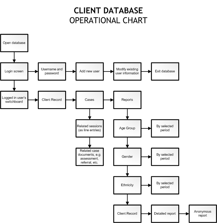

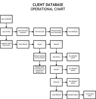

Also, the attached JPEG will give you an idea of what I'm trying to achieve.
Topaz
Your chart looks pretty good. What I wonder is who is going to be adding new users? Hopefully someone who has permission (privileges) to do so.
One other thing. Even though Reports tied directly to Cases seems the logical connection, it is possible that the reports will actually take place on a Sessions layout. Because that is where the "many" records exist, and where the dates for sessions exist (if that matters, likely). All other info is also available there, as either related fields (client name), or as direct lookups.
If you do a lot of reporting summaries by age, gender, ethnicity, then you might want to look up that data into the sessions table, so it is local. It's not very large chunks of data. Not really something to worry about either way.
I will be the only person to have administrative rights, so new accounts can only be created by myself. All staff will have access to Case records that contain their Staff ID (hopefully I've got the right idea).
Yes, I also thought about the connection between reporting, Cases and Sessions. For our reporting methods and the information we require, that information is in Cases. We are only funded per case and not per session. Once I get the hang of all of this, I will most likely create reports for sessions so we can report to the Board and funders of the actual workload we carry out rather than just reporting to their specifications.
