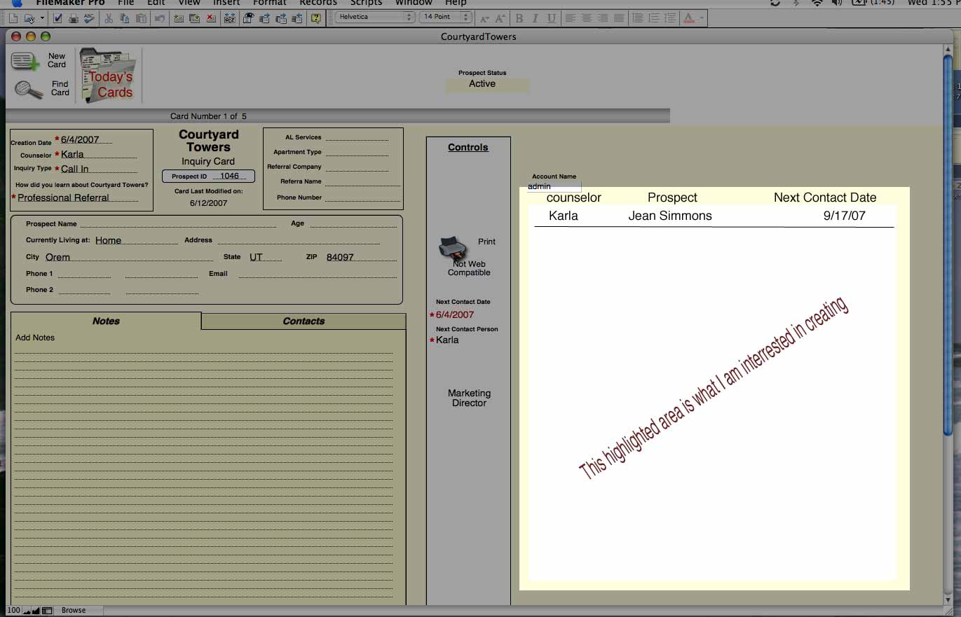

I am semi-new at FileMaker. I have been charged with taking our customer database electronic and I have been able to model the layout of our paper system.
We deal with prospects and their contacts and leave notes on the cards. I am interested in knowing if I can add a portal or some list to the right side of the card that lists all of the cards that are scheduled for today showing the following fields (Counselor, Prospect Name, Next Contact Date).
The reason I am doing so, is so that I can be working on a card and still see what I have left to do (maybe even navigate to that card by selecting it in the portal).
You will probably be disgusted with my organization of fields, but I am trying my best.
I am open to ANY HELP!

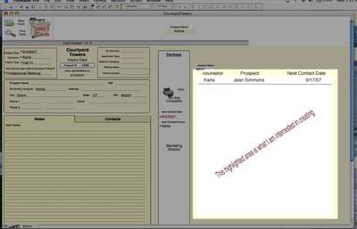

I have included the FileMaker file itself, so anyone can try to see what I am talking about (I can only upload "picture" files so I have changed the name of the file to .jpg whereas it is normally.fp7). Also, I have included an image file of what I am envision.
The username is admin
there is no password.

The relationships that don't go anywhere are my attempt at splitting up one large table with all of the current fields. After reading some tutorials I have been experimenting with relationships and trying to figure out they would apply to what I want to do; however, once I began I realized that I didn't know where I am going with the relationships.
This is what I have for each card:
Prospect
Name, address, info, etc....
Contact 1
Contact 2
Contact 3
Notes
Creation info
Modification info
These are all different area of what I want reported for every card. I don't know whether to keep them all in one table (what I have done before), or if there is a way and an advantage to making separate tables for each section of the card.
I know that I need relationships for portals, but I don't know how to have the Portal display a list of the found cards for the day, while I am working on one of the cards.
Please send any correction and help!!
