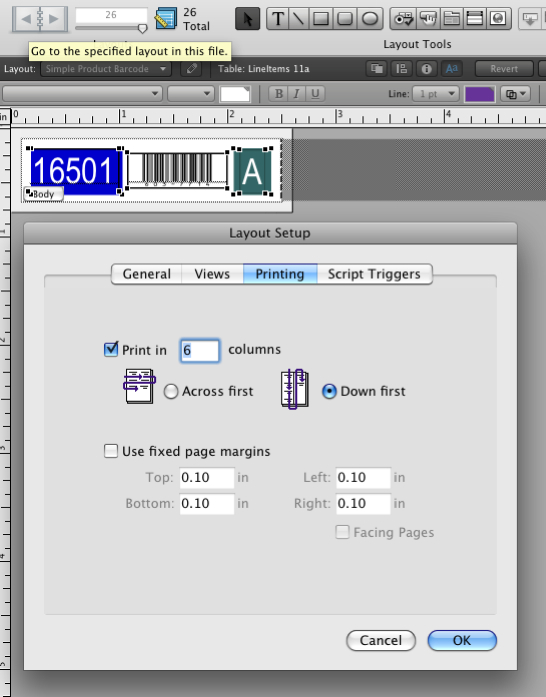

As you can see, there are 5 objects on this layout. A blue box, a green box, a serial number field (left), a text field (right) and a barcode field (center).
None of these objects extends off the layout. There are no invisible objects that might be responsible (I was careful to check).
The column printing is set to print in six columns, down first (so, six rows). Now...

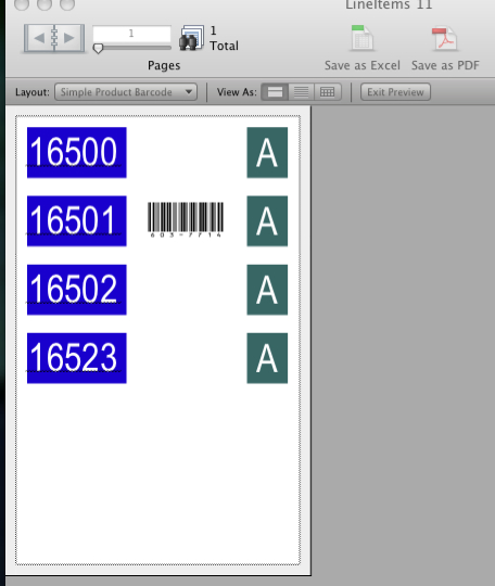

Instead of six rows of 5 objects, I get four rows of 4 objects and then an almost randomly placed barcode field (it usually shows up somewhere around the 3rd or 4th row and only displays once). There's nothing anomalous about the barcode field. It's the same as the serial number field, except that it happens to use a different font and it doesn't extend off the layout. It is set to be centered, the same as the other objects.
Also notice, even though there's plenty of space, only four columns are displayed rather than five or six. Things get even weirder if I switch from portrait to landscape mode. Filemaker will indicate vertical columns even though the layout is set for horizontal columns (rows).

All right. I used the word "rows" because I thought it would be clearer as to which direction I meant (printing down first or printing across first), but nevertheless, why does it only show four "columns" (printing down first) when I select six and there is room for six (as you can see in the picture)?

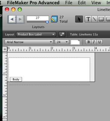

Here are some of the other problems I'm encountering. Again, this doesn't seem to happen when I use letter-sized paper, only small formats. If anyone can enlighten me, I'd appreciate it. I used to earn a modest living with Pagemaker + SuperBase. They had some bugs, but not ones that interfered with my ability to finish products for clients. Now I struggle constantly with scripts (scripts were easy in SuperBase), with printing, with so many aspects of Filemaker, I lose more than I earn.

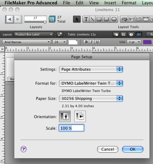

Okay... here are my printer settings in Page Setup for Dymo Twin on standard shipping/badge labels:
LabelSetup1.jpg which, to my surprise, yields this: LabelSetup1b.jpg
Filemaker Pro seems to think the page size is 4" x 1.7" and, of course, won't let me stretch the Body beyond the page size.

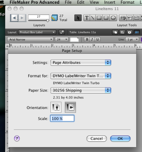

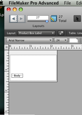

If I change from landscape to portrait mode:
LabelSetup2.jpg this setting yields this: LabelSetup2b.jpg
Filemaker now seems to think the paper size is 2.31" x 1.5".

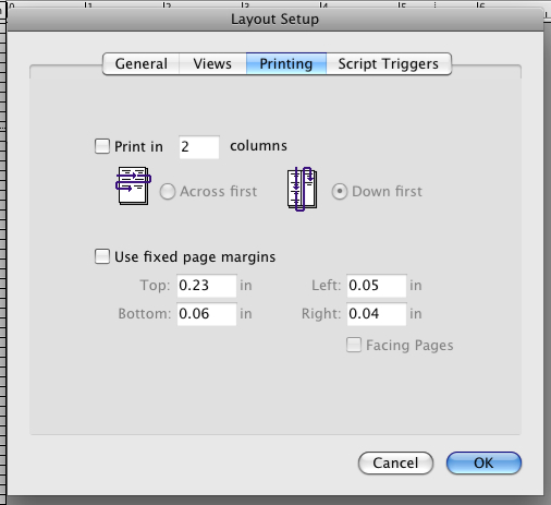

This is with columns turned off, and the margins are determined by Filemaker Pro 10 Advanced (I can't manually size the page bigger):
This doesn't make any sense to me. As I mentioned before, I don't have trouble printing correctly from other apps (word processors, dedicated label printing apps, etc.) so I'm pretty sure the printer driver is fine.
I'm pretty desperate to solve this. About 80% of my projects are small-format printing (inventory labels, box labels, file labels, name badges, etc.). Am I doing something wrong? If not, are there workarounds?
In layout mode, go into the View menu and turn off Page Margins.
There is no reason why the body cannot be resized beyond one page. I'm thinking the file might have corruption.
This looks fairly simple.. Your page setup size is 4 x 2.31. Your Filemaker "page" is the same. There is no way it will ever put the layout more than 1 up.. Looking at your print setup, it appears as if you are trying to print to a label printer. The repeat of the label will have to be your page size.. period. If you are trying to print multiple records up on 1 label, you have another whole set of issues...
