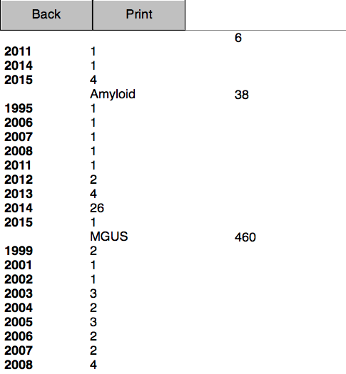

Hello I am unsure how to do this or even if it is possible at all. I have a report that reports the Myeloma (Bone marrow cancer) subtype diagnoses corresponding to the year. I want the report to look like and print like this:
       Year        Myeloma        MGUS           Myeloma-LC
Ex.   2010          4                    4                         2
Total                 4                     4                          2
Now the subtype is in a field called diagnosis and there is a count= count(pk_dx) that counts the diagnosis. I attached a screenshot how the report looks currently. I just want the diagnoses as headers with the years going down vertically. Thanks for the help!
Google cross-tab report. It's not "built-in" to Filemaker, but it can be done.
This is possible only if the number of columns is known in advance. Filemaker is not flexible in the horizontal direction and will not add columns dynamically.
