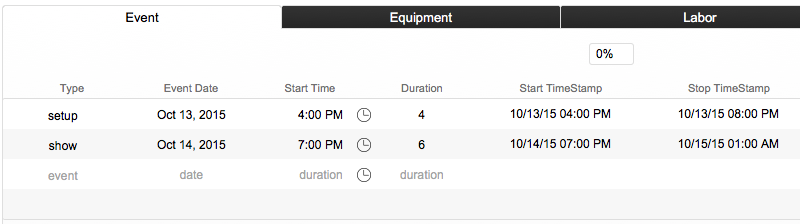

thanks comment - for the  data entry they will be individual fields so data entry can be done thru pull downs for quicker and more consistent data.
 have a calculation time field that results as timestamp, perhaps the DateEnd will default to the DateStart and then thru some trigger scripted logic it will advance when the EndTime is ≥ 12AM, I still need to get confirmation from client but if I just have them provide the start time and the "total hour duration" then the end time could be calculated, it would save having enter all the extra end date/time elements.

I am afraid you kinda lost me there. If you're entering the duration instead of end time, then calculating the end - whether as date, time or timestamp - is rather trivial. There's no need for any 'default" value for the date of the end, Filemaker will do the adjustment automatically. For example:
Timestamp ( StartDate ; Time ( StartHour ; StartMinute ; 0 ) + 3600 * Duration )
will return "10/5/2015 2:45" when:
StartDate = 10/4/2015
StartHour = 22
StartMinute = 15
Duration = 4.5

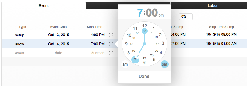

However - I think i see where you are leading me, presentation and  entry vs a data storage & calculation - I think the approach would be to provide what ever interface needed to facilitated the end users data entry requirements & validation - and then on commit the data is stored naturally 24 hour timestamp or even a simple numerical value. As all presentation references derived from these results can be formatted in any fashion.
Not necessarily. It doesn't really matter how the data is stored - you can always recalculate it in whatever format you need.
