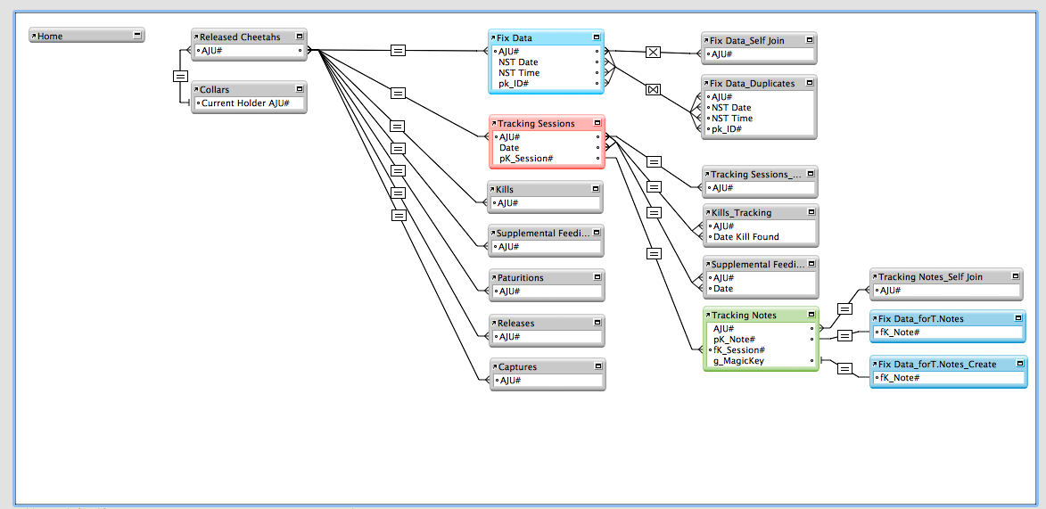

If anyone has any ideas on how to accomplish what it is I'm trying to do, I'd really appreciate it. I've included an image here of my relationship graph and the relevant tables highlighted in varying colours. As you can see, I've created two new occurrences of 'Fix Data' so far. If I need to provide any further details or clarify anything please let me know.... I'm quite new to Filemaker.

The global field g_magicKey selects the target record.
If you want to EDIT that record; capture the ID (fk_Note# in this case) and set  g_magicKey to this value.
Then you can use set field to update fields in the selected record.
See example file attached.

Thanks Bruce! So setting g_magicKey to fk_Note# and then performing the Set Field across the Tracking Notes = Fix Data_forT.Notes_Create relationship will update the existing record in Fix Data rather than creating a entirely new record?
