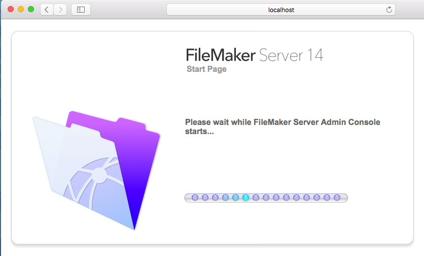

Filemaker 14 Pro Server 14.0.4a on El Capitan Server 10.11.2
I installed from downloaded image v14.0.4 and then patched to 14.0.4a.
When I go to http://localhost:16001 - nothing happens. It just sits on the screen saying that "Admin Console is starting...".  I've not been able to deploy or setup anything yet.
During install, it is setup to use alternate ports, namely 8080 and 8081 (http, ssl) respectively.

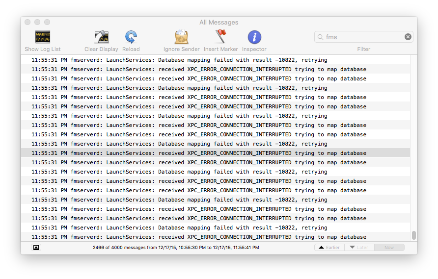

When I go to the Console logs, I see this error repeated: XPC_ERROR_CONNECTION_INTERRUPTED trying to map database

FileMaker Server is not compatible with El Capitan Server.   That could be causing the problem   There are a lot of issues with trying to run OS X Server and FileMaker Server on the same box.
Most of the problems involve Apache but there are workarounds. Search the forum for info about this.

Also I assume the problem had already been solved by 2b3pro and I can't be sure, but those ports, especially 8080 could've been in use by the Server.app's internal proxy process. FMS setup usually warns about those but it's possible that they were closed during the setup process and got opened again after a reboot.
