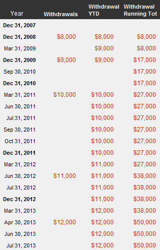

I have added an additional TO to sum the withdrawals in a set of financial records by year, Withdrawal YTD column. I would like to show the yearly Withdrawal YTD sum in the last record of the year only and be blank in all of the other months in the given year, it may be Dec 31 or may not. All of the records would still be there, only some the values in the Withdrawal YTD column would be blanked. In this example only these values would show in the Withdrawal YTD column.
Dec 31, 2008   $8,000
Dec 31, 2009   $9,000
Dec 31, 2010   blank
Dec 31, 2011   $10,000
Dec 31, 2012   $11,000
Jul 31, 2013  $12,000
