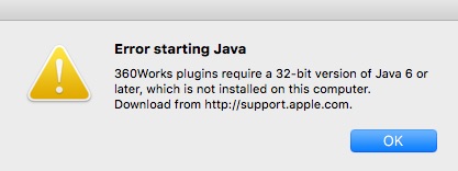

When launching FMPA 14 with Scribe 2.15 installed (also occurred with 2.091) I get the error:
Quote
Error Starting Java: 360Works plugins require a 32-bit version of Java 6 or later, which is not installed on this computer.
However it is installed. Java 8 had been been previously installed as well but has been removed from the system. The error persists.

Hi Paul,
It looks like you are on a Mac. On Mac, our plugins require a specific version of Java 6. It can be downloaded here https://support.apple.com/kb/dl1572 . Is that the version of Java that you have installed?

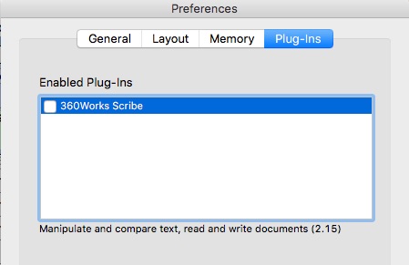

The error occurs when any of the following plugins are individually installed:
  • 360Works_CloudMail 1.0
  • 360Works_Email 2.14
  • 360Works_Scribe 2.15
  • SuperContainer_Companion_Plugin 2.93
As a control I tried having only CNS_Menu 1.1.14.2 installed and there was no error.
On launch with just Scribe installed I get the error then FMPA launches with the plugin disabled. The app is set to open in 32-bit mode.

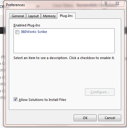

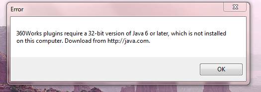

We're experience the same issue on 32-bit Windows 7. FileMaker Pro Advanced 14.0.4.
Fla6thCir,
This issue is a bit different on Windows because there are no stipulations on the Java that you can use. Can you confirm that you are using a 32-bit version of Java, preferably Java 8 ?
Ryan, yes I can confirm that it is 32-bit Java. The version on this desktop is v6.31. We can't update Java as there is another mission critical multi-agency application that won't run on anything higher. We're still a year away from replacing that piece of software. The plug-in had been working flawlessly since it was installed in July. It ran fine earlier in the week but stopped working mid-week.
...dave
Dave,
What version of the plugin are you running now?

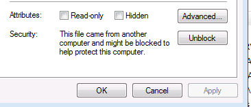

Ryan, when checking Properties of the plug-in I noticed that the plug had been blocked. I unblocked it and re-launched FMPA. The error messages disappeared, the plug-in had installed and was working again. Our Admins pushed a Windows patch and security updates mid-week and I am pretty sure that this caused the blocking.
