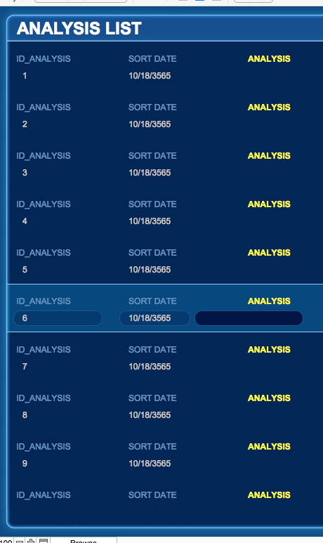

I have tried implementing what you said. But I cant seem to get it working. I don't really know where messed. I have attached the file, if you have time you can go through it. Thanks for your response
ANALYSIS.fmp12

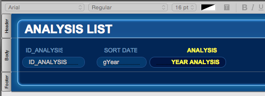

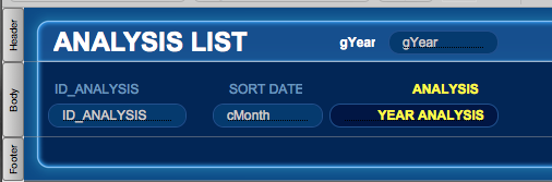

You placed the gYear field on the layout.
You labeled it Sort Date
You entered not only the wrong year; but a not "year" value at all.
Instead, you entered a strange date: 10/18/3565.
If you set up the fields properly, you get what appears to be a correct result.

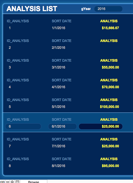

gYear_result.pngthis is what I have implemented.. and this is it what i want to represent on the chart

What I want to be displayed on the chart is the Analysis amount for each month , with respect to the Organization selected
Okay, so why is this a problem? Make SORT DATE your X axis field and ANALYSIS the Y axis field, and set your chart to use data from current found set.
