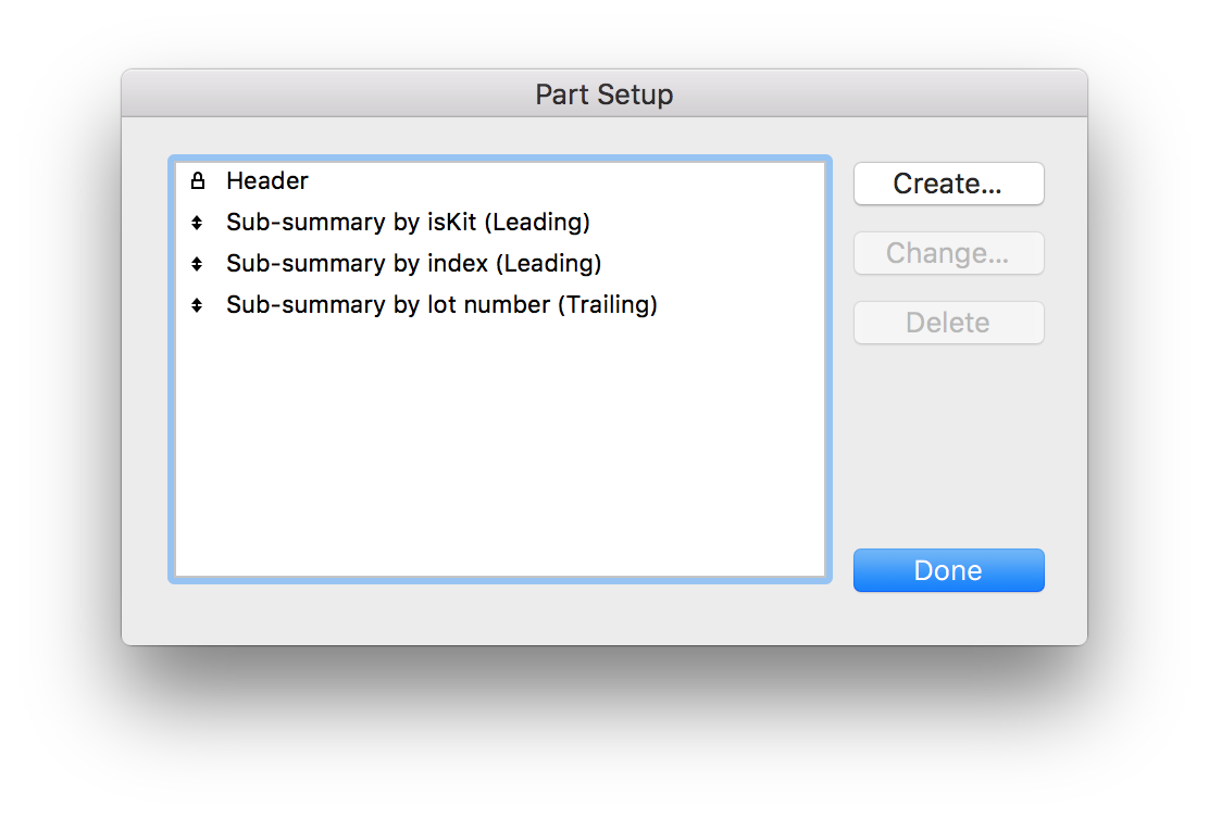

Been wrestling this for a bit - i have a sub-summary report that has no body part  and summarizing and sorting by group and lot numbers
in the portal for data entry they appear in natural order (the order entered)
There are other fields that are entered or multiple records for one lot number however on the report we need it summarized but we would like the lot numbers to be in the natural order as they were entered in the portal.
I am trying to figure out a way to force the lot numbers in the natural order.
Could you provide a clearer description? I got lost trying to figure it out. How many sub-summary parts do you have?
56b3c59113ffa_ScreenShot2016-02-04at1.41
in short of a better option i had to generate the report before the fedex gal came to pickup the packages
what i ended up doing is this GTRR to all the items no sort on relationship so everything is in natural order.
then i serialized a number field starting at 1. then looped thru the set of records and setup a multi predicate relationship based on the lot number and invoice and then if the relationship matched set the local serial field to that of the related value.
Then changed the last part to be sorted by their serial field
it worked but means have to touch every record every time it's printed.
Could you get the record number in a calc and then sort by that? Sounds too simple.
