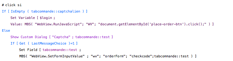

March 7, 201610 yr Author Hi Kris M, thanks you for the answer, i try right now with the popover but i can't use a script with it ? right now with dialog box it s working like this i click to a "button x" > script load captcha picture from webviewer >show it bigger> open dialog box> I put the character > I click ok >script put it in the field captcha of webviewer> script simulate click on "validate" of the webviewer > done what i would like is that the click on OK of dialog box will be done automatically if i put 4 characters. you think it could work with popover ? thanks you
