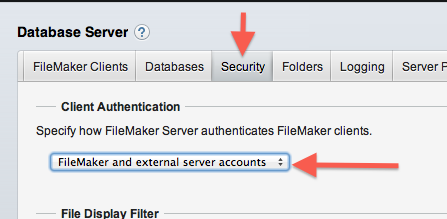

In FM, the only thing you need to do to make make AD authentication work are:
- FMS needs to be a member server of the domain (you have that already)
- FMS needs to be configured to allow "filemaker and external accounts" (nothing else, not that "directory service" section)
- the FM file needs to have external accounts (groups) set up

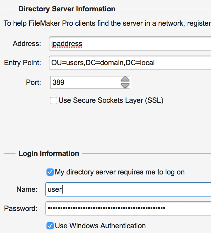

I am referring to the authentication of user names against an Active Directory. You set up a server, and must give them FQDN a port and a type of encryption.
Done!  Indeed it works!  But using non encrypted connection, thus, raising alarms in the DC.

You activate it in the admin console, under the 'Database Server' --> 'Directory Service' --> 'Use Secure Sockets Layer'.  AD is listening on 686 for the SSL connection.

This is the part that I mentioned before: that "directory service" section of FMS has NOTHING to do with authenticating users.  It is only there to let people find info about the FMS in their directory service.  So whether you use this section or not, it does not make one bit of difference for the authentication of users.
Right.  You are right.  But notice that my problem is that when the FMS goes to check the AD, it does so without any encryption and in plain text.  Thats why I would like it to be secure.

Then, what does that check mark do on that 'Directory Service' do?
What check mark exactly?
Note that the "directory service" section of the FMS admin console has NOTHING to do with authentication of users, as mentioned a few times before.  It is meant to allow people to find filemaker servers in a big / heavily segmented network.

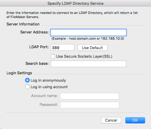

It can go hand in hand with similar settings in FileMaker Pro (client) (see screenshot)

The check mark is the one that says "Use Secure Sockets Layer (SSL)" on the picture.

The tab you are displaying for LDAP registration has nothing to do with External Server Authentication for FIleMaker Pro files.  Its only purpose is to publish a list of the FIleMaker Servers on a network.  You'd probably be better of not using the LDAP item at all.
