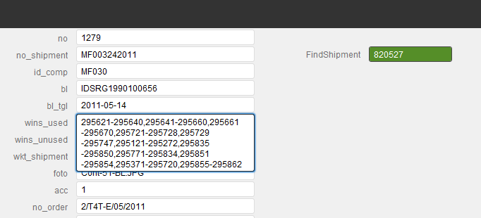

Building on this last solution, I realize I have another more complicated problem. I am trying to perform a find on records which have a single field that must be parsed into multiple criteria. I am trying to finding a single record that has a field that contains data like this "295621-295640,295642-295660,295662,295670,....". Find criteria would be for example 295645, always a single number. I think I need to step through the data in each record, parse the start and end numbers of the ranges with the hyphen perform a find and then start a new find range with a comma. If there is no hyphen, then it is a non-sequential number that still has to be detected and searched. Some of the records can have 100's of these mixed sequences in them. The current database has around 30,000 records in this table and growing quickly so the time to step through all this to find where a number fits could become problematic but that is a secondary concern. If it takes a minute or two to perform the find, no big problem.

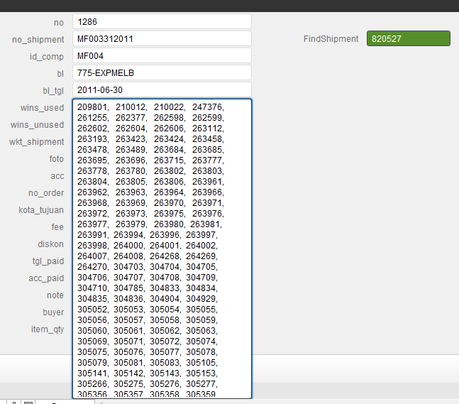

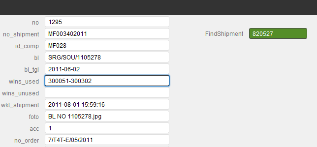

I have a table with some records, in each record is a field that has this mixture of ranges and single, non-sequential numbers. The content in this field varies from record to record, some can be just a single number, some can be a contiguous range i.e. 12345-12350. But often there are a mix of both contiguous ranges and non-sequential single numbers i.e. 12345-12350,12360,12362...etc. The numbers to find can vary in length from a single digit to the millions. I need to find the record which, in that field, my find criteria matches either by a direct match with a single non-sequential number or within the range of the range type numbers, i.e. 12347 is found in the record that has the data in the field I am finding in "12345-12350,12360,12362". I have attached here some examples of the numbers in the field I want to search. To reiterate, I am trying to find the record that my search criteria matched in the wins_used field you see in the attachments. Basically the application is to find which shipment a particular serial number (win) was in. My operation is to put the Find criteria in the FindShipment field, you see in the image, then trigger a script to search through the wins_used field in all the records.

That's not possible. Your field contains not numbers, but text - a bunch of meaningless words. By performing a find, you can find records that contain words that begin with a given string (this is the default find) or records that contain the given string.
You will need to restructure your database and put all those values into individual records in a related table. Or perhaps enumerate the ranges as individual numbers.
