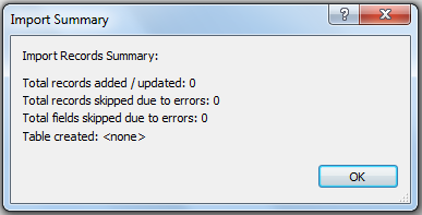

When I try to import my XML file into Filemaker using the stylesheet I created, It looks like all the fields are mapping right, but I don't get data in any of the fields. I get the following pop up message:
This is the stylesheet I have built so far, the sample XML data we were provided is attached. Can anyone point me in the right direction as far as what my problem is and what I need to fix? As an aside, I know I have the CustomerReferenceID field importing twice. Given the sample data we received we're not quite sure which fields we will actually need to import so I'm using one of those entries as a placeholder.

There are two major problems with your stylesheet:
First, your XML source places all its elements in a namespace: xmlns="http://www.windowbook.com/pwnedoc/1.0". To select such elements by their name, you must use a fully-qualified name.  That means declaring the namespace in your stylesheet, assigning it a prefix, and using this prefix when addressing the elements in the source document.
The second problem is that your template puts you in the context of the / root node. From this context, the instruction:
<xsl:for-each select="PostageStatement">
does not select anything, because PostageStatement is not a child of the current node.
Here is your stylesheet with the two major flaws corrected (and some redundant nodes removed):

Thank you so much! Now I get data importing at least, hopefully the rest I can figure out by myself. Ah the joys of working at a company with no IT department. :)
