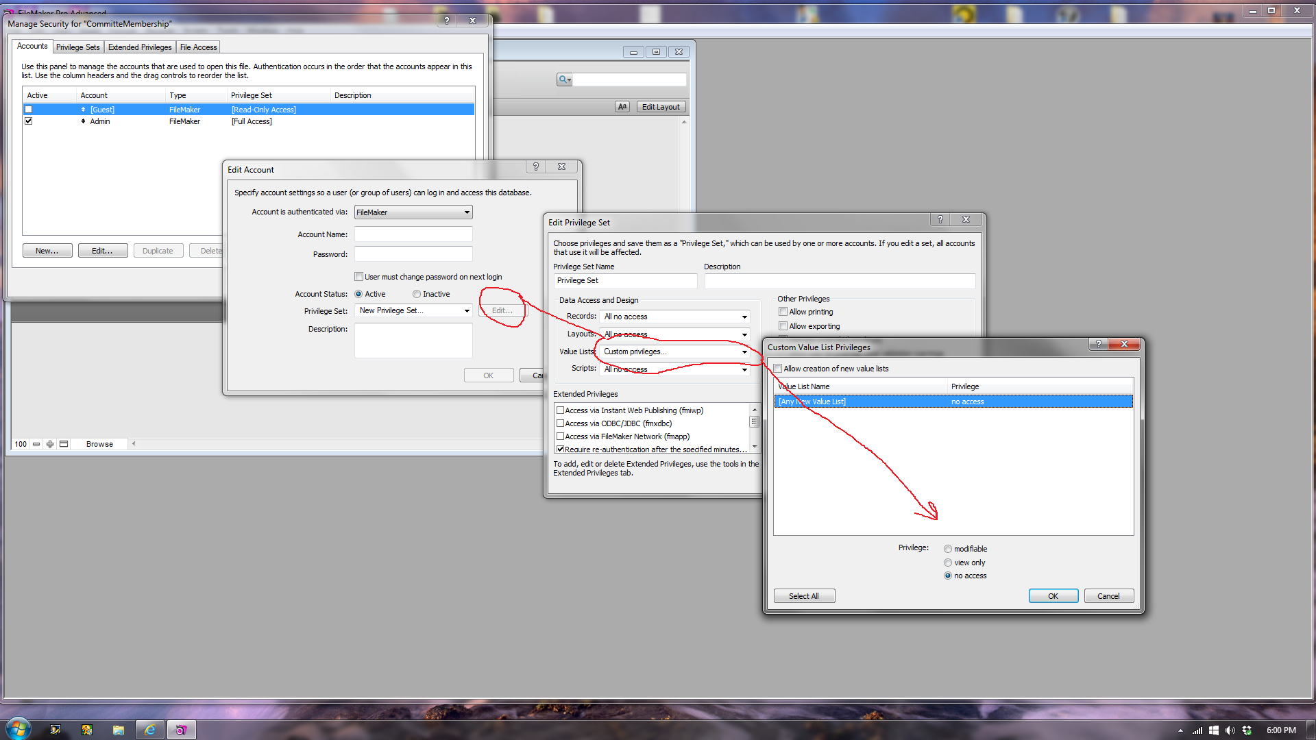

Does this help?
1 hour ago, Steve Martino said:
Does this help?
Just from looking at your screenshots (correct me if I'm wrong), it looks like you're just modifying a privilege set to not allow access to value lists.  I'm trying to find a way to enable/disable the "allow editing of value list" option, currently only available in Inspector, and either always on or off.
