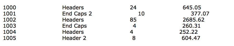

I need control of my column width.
The following SQL select is perfect with the results I want except I have been unsuccessful in finding a way to set my column width.  All I can do is to set my delimiter by 15 - 20 spaces which pushes the results apart but they are staggered depending on the field data's length.
Filemaker's SQL pdf reference doesn't seem to reference a way to control the "Width" of a column within an SQL statement.
I tried the "Right( )" but it only threw a "?" in the results and I had to remove them for "Quantity and Item_Cost_Plus_MU"
Does anybody have a suggestion.  I would be grateful.

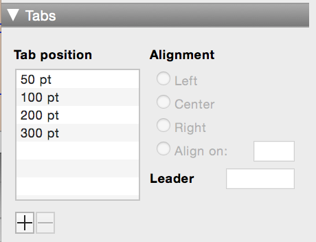

Char (9) work perfectly but the Tab spacing seemed to be ignored.
Filemaker Help does really explain where the issue could be
Please see pic
Any suggestion I would be grateful
Tab stops can be set on the field (in layout mode) and the Char(9) will absolutely be honored in the Text field results for ExecuteSQL(). I do it all the time (including decimal-aligned)! However, you appear to be trying to format only a section of the text. Any tab settings are a part of the entire text returned from the query.

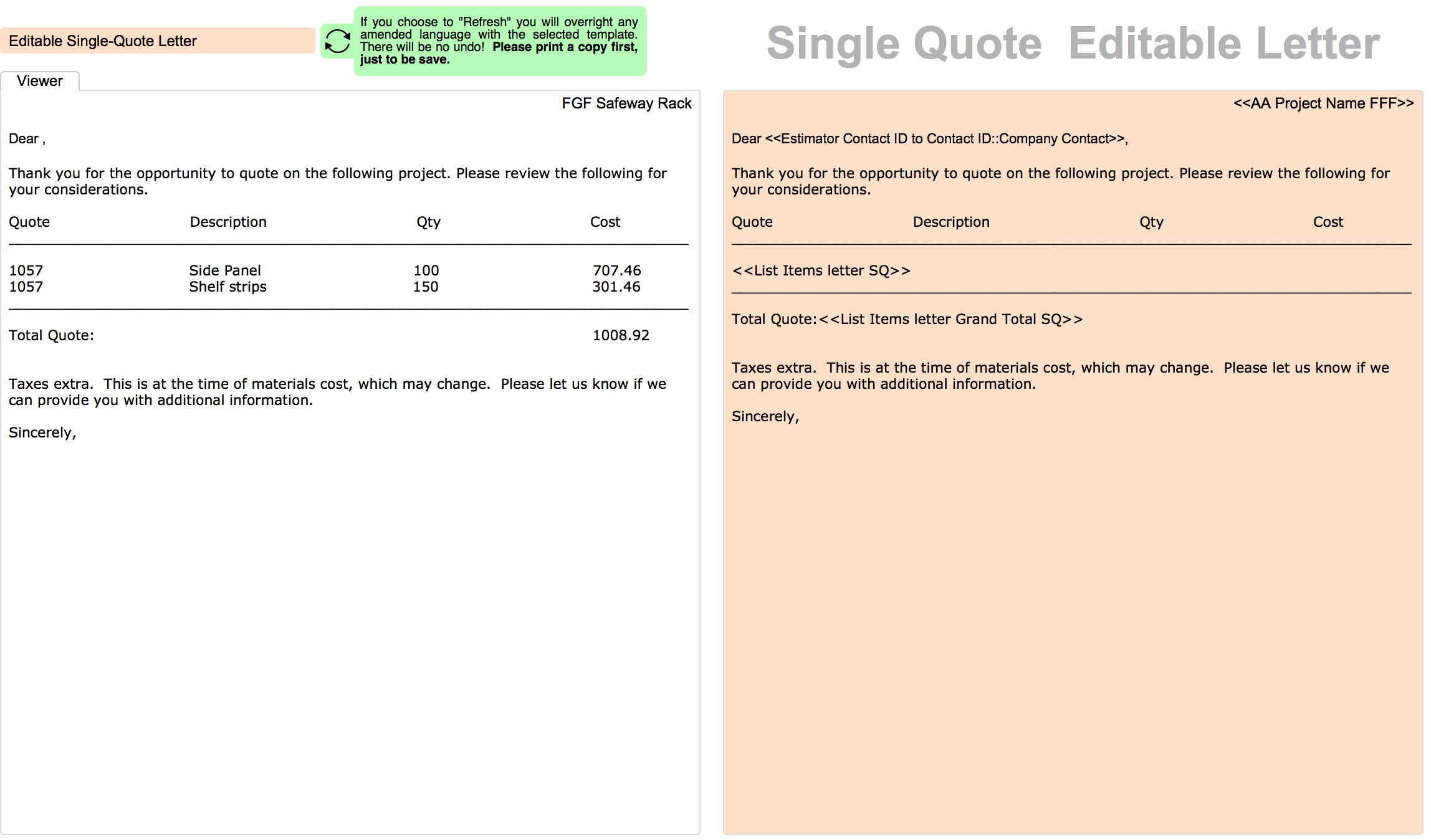

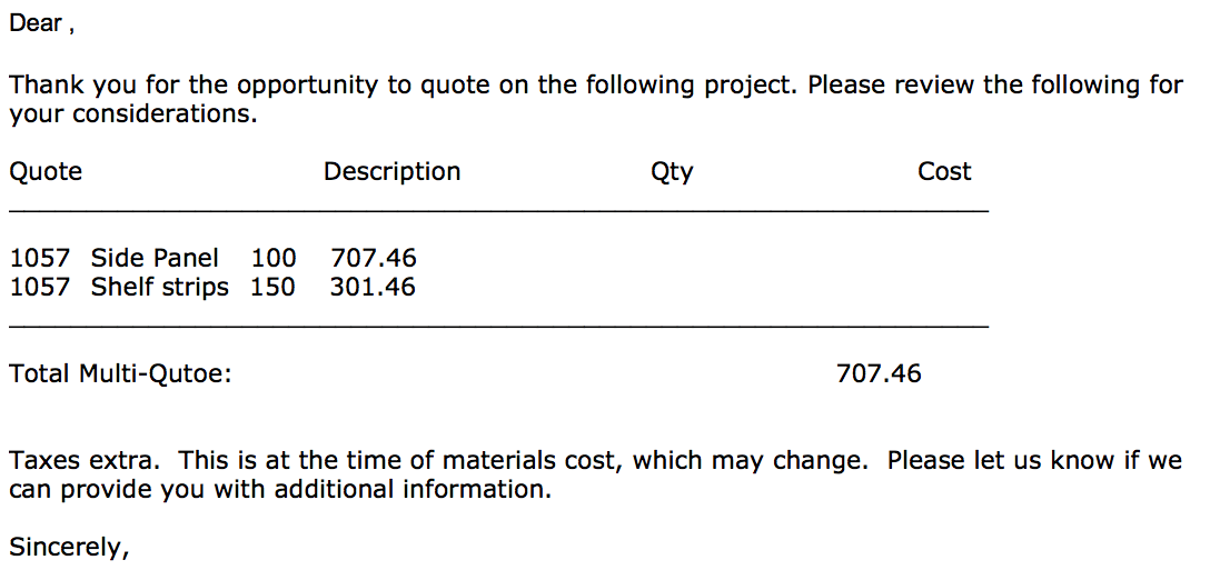

I'm building an editable letter ...
Based on what Comment said using Char(9) in the field separator I've done the following.
This is the field "List Items Letter SQ" that carries the sql ...

This field calculation that hold the Quote Total "List Items Letter Grand Total SQ"
Char(9) & Char(9) & Char(9) & Char(9) & Char(9) & Char(9) & Char(9) & Char(9) & Char(9) & Char(9) & Char(9) & Char(9) & Round ( Sum ( Estimator RFQ ID to Items RFQ ID::Item_Cost_Plus_MU ); 2)

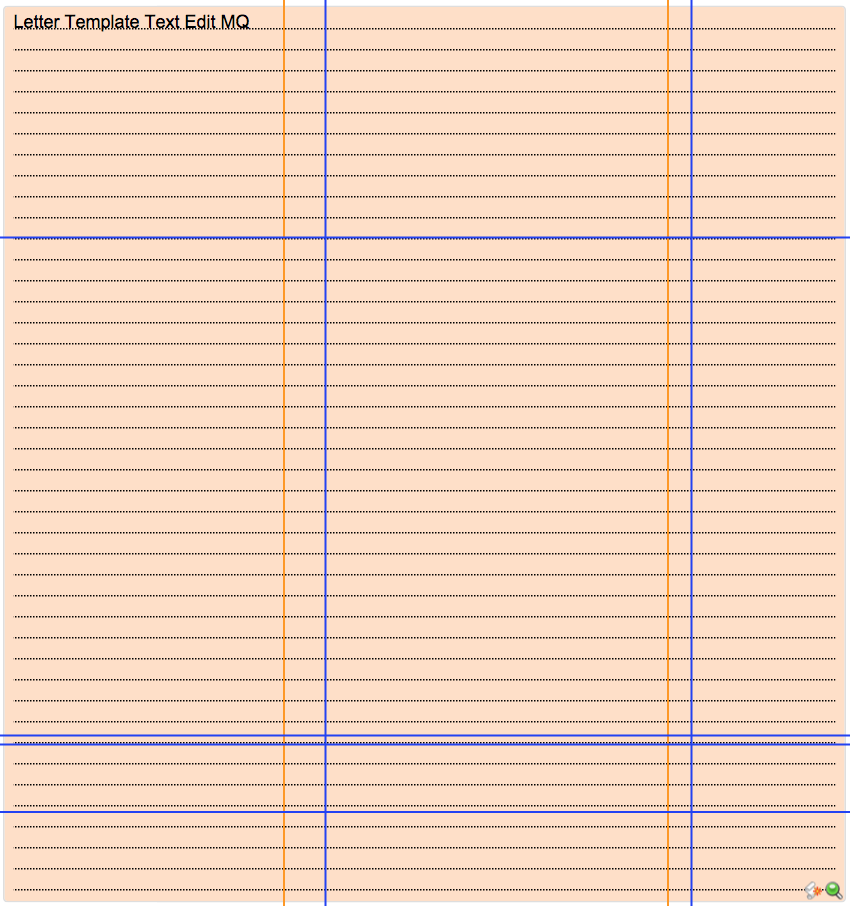

This editable letter comes from a previous link provide from the "Forum" that handle the "Tags" within the letter which was a struggle for me but amazing when I got it.  The orange field is where the customer will "Edit" the text and as you can see, I would love to be able to right align the "Qty" and the "Total" value but I am completely lost with regard to this "Tab" feature recommended by Comment.  It sounds like this "Tab" control will work if I can implement it but it's a blur right now.

Hard to pinpoint the problem with so many things going on at once - and some only partially described.
For one thing, you should use only a single Char (9) character as the field separator in the ExecuteSQL() function.
For another, you seem to be using not a field, but a text object with merge fields to display the formatted result. Make sure that the tab stops you show are the tab stops set for that text object, and that the paragraph containing the ExecuteSQL result does not have an overriding setting (like most text formats, tab stops can be set individually for each paragraph).

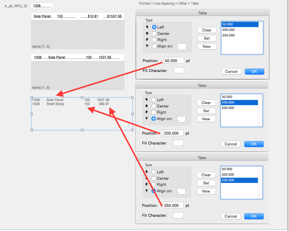

See if the attached is helpful.
ItemTabs.fmp12.zip
any separator is ok in ExecuteSQL() and if 4 'tabs' (HT) work, there is no problem.  The align on decimal is very powerful!
I was not sure what "tab control" means, unless it's the tab settings/tab stops for the object as bruce shows you. Are you able to find these dialogs?

I was able to duplicate your results by creating another field and putting in the "tab" control and it work great.  So I am grateful for that understanding, thank you.
However, the sql field is typed into a template text field where I wrote this letter ... Dear John ... <<fieldName>> etc ... this tag field isn't selectable as a text block, its' just text.
I picked up a function that takes these "tag" fields  and replaces them with their relative data.
I may be missing it completely here but the sql field that is selectable in your demo file ... my sql field since they live in the letter itself are not selectable as a text block.
Again, I don't know, I my have missed your point.

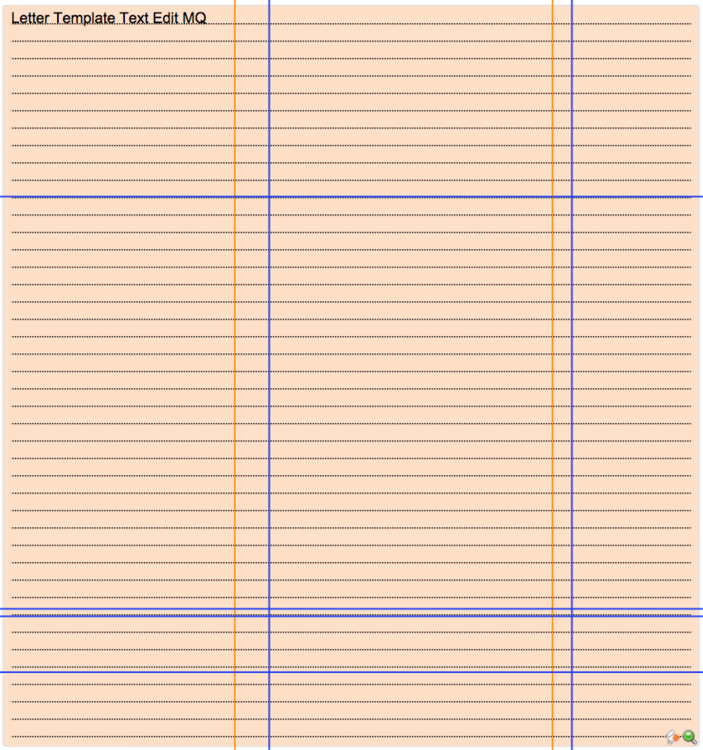

Anyway, see pic of field I push the template too.  I tried placing the "tab" control on this field and when the function replaces those "tag" fields with their respective data the tab control isn't applied since I could never select the sql field itself.
So thank you for the understanding of the "Tab" control.
I have no idea what "placing the tab control on the field" means.
It isn't a tab control. It ruler formatting.
BruceR,
Ok ... ruler then.
My point being, your sql field is selectable in your demo to set up the "Ruler", my sql field it is not selectable, meaning it is part of a text document (Letter) that I wrote in a field on my template table and the sql field(s) are merged within the text of my letter field ... Dear <<fieldname>>, and this text field template I use a relationship to set the letter text field on the table where the quote lives
Anyway Bruce, you've guided me in the understanding of this "Ruler" which is more important.  That demo file was excellent, it was what I needed.  So thank you for that :-)
Thank you.
The style of the section of the TEMPLATE will be applied to the result.
It is very difficult to understand what you're saying. Please refer to the help if you don't know what something is called.
I think what you describe is a text block that contains merge fields. And (as I said earlier) a text block has its own tab setting. If you select the entire block (by clicking on it once), you can then adjust the tab settings for the entire text block. You can do this using the Inspector or the text ruler.
In addition (as I also said earlier) you can set different tab stops for each individual paragraph of the text block. Note that you cannot set tab stops for an individual merge field - but you can set individual tab stops for the paragraph that contains that merge field.
