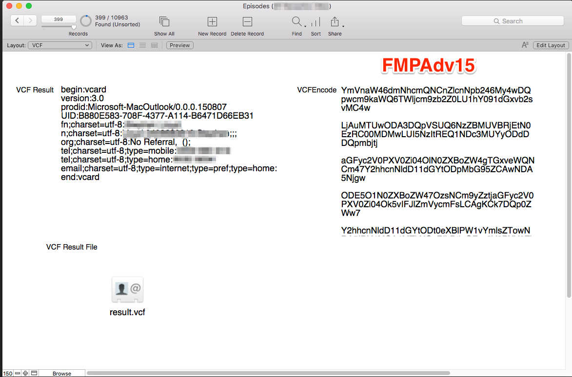

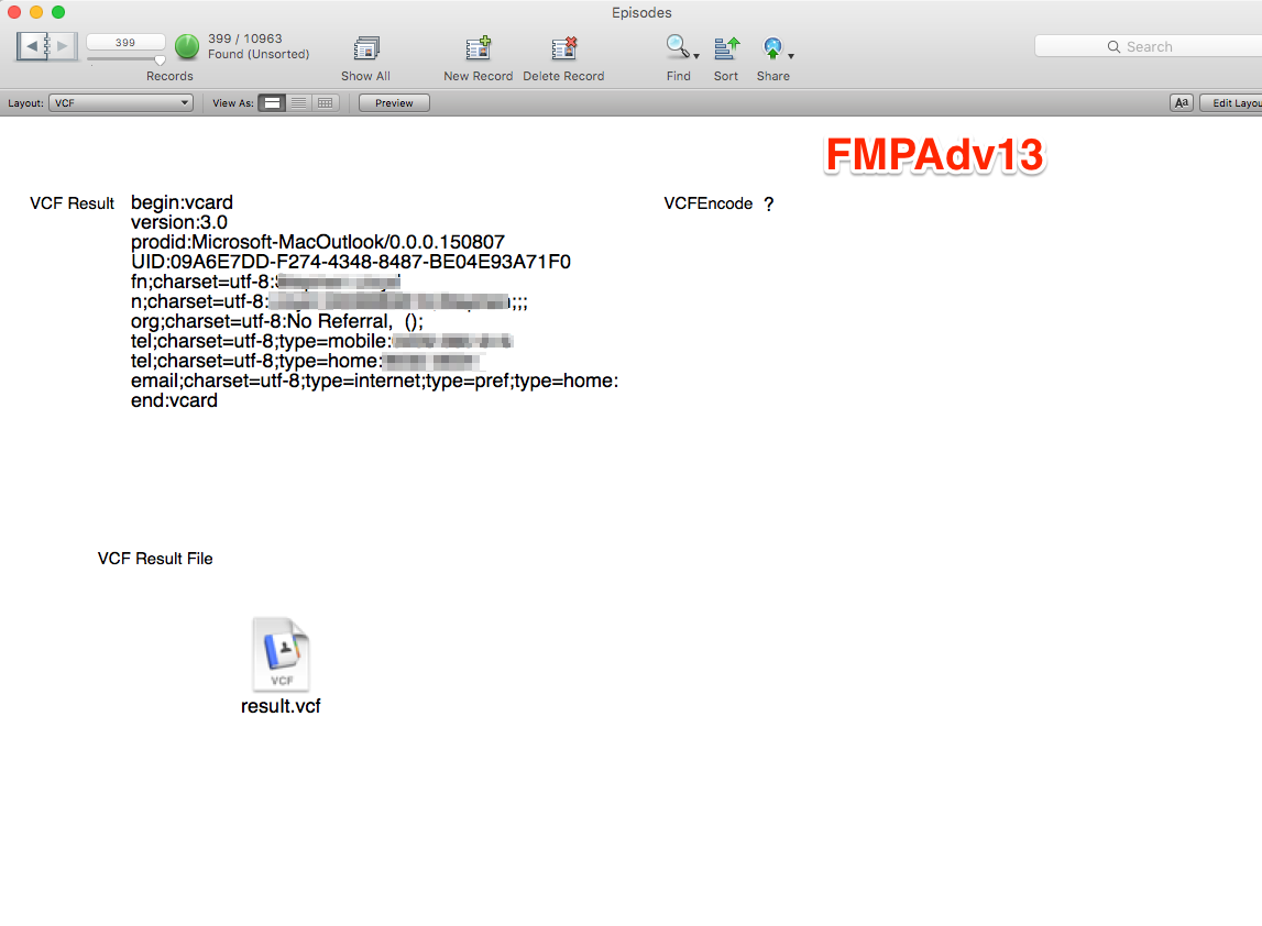

I recently tried to implement a Base64 Encode/Decode approach to create a vCard from FMPro as previously described in this post https://radicalappdev.com/blog_02/. The file resides on an iMac at my front office desk running FMPAdv13. When opening the file and running the Base64 script to export the vCard on this Mac, I get an empty card however if I run the file from from FMPAdv15 from my laptop on the same network (hosted on the FMPAdv13 Mac) the vCard is exported as expected.
I looked at the encode function and found that in the FM13 file the field has a single "?" however in the FM15 view it is filled with data (screenshots attached).

Perhaps you should have read that post to the end - where it says that support for encoding text in Base64 format was only added in version 14.

The ability to encode text files was new in 14.
