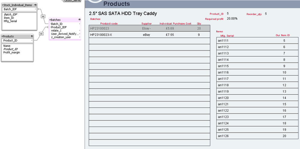

Having discussed this at length we have the following structure and basic layout of a single stock (we are calling it product) as per the attachment. What we really need to do is track precisely which individual item has gone where, so each of the 'Items' records has the manufacturer serial and is referenced somehow when the items are sold - I haven't seen this in any examples.
However what we would also like to retain is the ability to sell products with a quantity above 1, as a single line, even if it spans multiple batches. In order to track precisely which individual items were sold, e.g.
25x 2.5 SAS SATA HDD Tray Caddy
Would this require the use of multikeys?
Is this a sensible approach to stock management?
Edited by sal88

OK having looked in this further I think I can see things a bit clearer.
Does this set up conform to the standard?
We will do away with the individual items table. So we are just left with Products and Batches.
The products table has a 'qty at hand' field which is a calculation that sums related batch quantities.
It also has a 'sold qty' field, and a 'current qty' auto-enter field which subtracts 'sold qty' from 'qty at hand'.
When a supplier shipment comes in, this is added as a new batch record. Qty and purchase cost are recorded, as well as supplier details and order no.
When selling items the quantity that is being sold is added to the 'sold qty' field in the Products record. This sold item record is what the invoice pulls in.
An item cannot be sold if the 'current qty' of the Product record is zero (or below the required qty).
When selling items the purchase cost is pulled in - this is the average purchase cost of all remaining batches. This is worked out using the Product current qty field and the most recent batches' purchase costs (not entirely sure what this calculation would look like).
When sold Items are leaving our stock room the manufacturer serials numbers are individually scanned in and recorded in the sold Item record (the one that appears on the invoice).
Am I right in thinking that what is missing from here (as far as the standard arrangement goes) - is an 'inventory out' transaction record every time items are removed from the stock room? I can tell that long term this is the right thing to do but I can't get my head around why!?
Edited by sal88

2. An OUT inventory transaction is made when it is shipped
One potential difference here is that many Items are not actually shipped, they are taken with the engineer onsite (a customer's premises) - at which point the status of the Line Item is changed to 'checked out'. If they return with the item then the Line Item is deleted, but if it remains on site then it is sold and the delivery status is changed to 'delivered'. Also, it isn't uncommon for an engineer to go on site with a number of items - not knowing whether they will use them all. therefore a number will be returned to stock.
My instinct is telling me that the best thing to do is stick to the inventory in/out process when things are returned, and for engineers to sell things only when they are actually sold. So they would take things to site (via an inventory OUT transaction) and then selling that which is remains on site, and then returning them to stock via an inventory IN transaction.
But then it's important that the purchase cost is included in inventory IN records. Does it make sense for inventory IN to be used for such returns? Would I include a 'returned from site' tickbox - whereby its population automatically pulls in the purchase cost via a slightly modified version of my above FIFO calculation.
But then if Items leave the stock room before they are sold, it is more complex to record the serials in the Line Item.
Sorry for yet another curveball! I think this is the last.
Edited by sal88
Unfortunately we've had to continue with a type of mishmash setup. I believe the main issue here is that the organisation in question is not actually a 'seller of stock', i.e. a sold item might not be shipped, a shipped item might not be sold. A shipped item will not find it's way back in to stock via a returns procedure as it might be returned to the warehouse before it has actually been sold. As I mentioned, we have engineers going to the customer with items that may or may not be sold to the customer. Furthermore we do need to stick to selling Items as per their individual purchase costs - there's no need for us to be setting sale prices per product which is what I initially thought.
Therefore all we have effectively done is just add the 'Products' parent table to the transactions (which are actually stock lines) so that the stock manager can more easily see what is going on.
Thanks for your help all the same Wim! I've learned a lot about how it should work!
