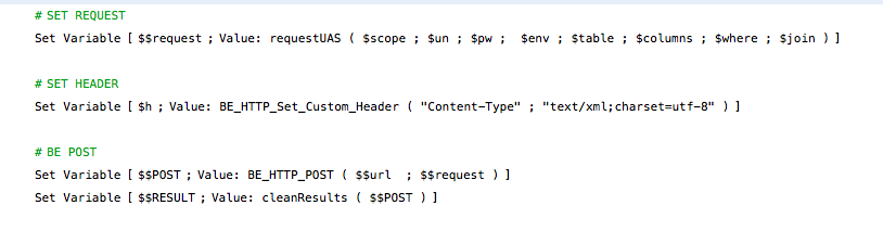

I'll send you the API list back channel hopefully MS can replace my current process of using BaseElements with requests to get the results. Then have to still write out files and import files (update matching)  one table I have to import adding as new as it is gathering aging information.
Screen Shot 2016-07-29 at 2.11.00 PM.png Screen Shot 2016-07-29 at 2.12.46 PM.png
