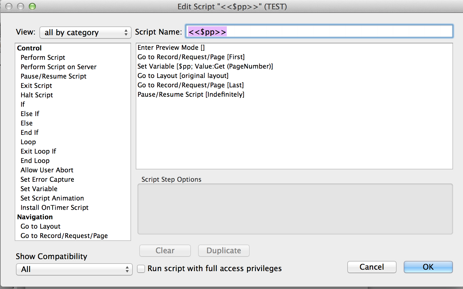

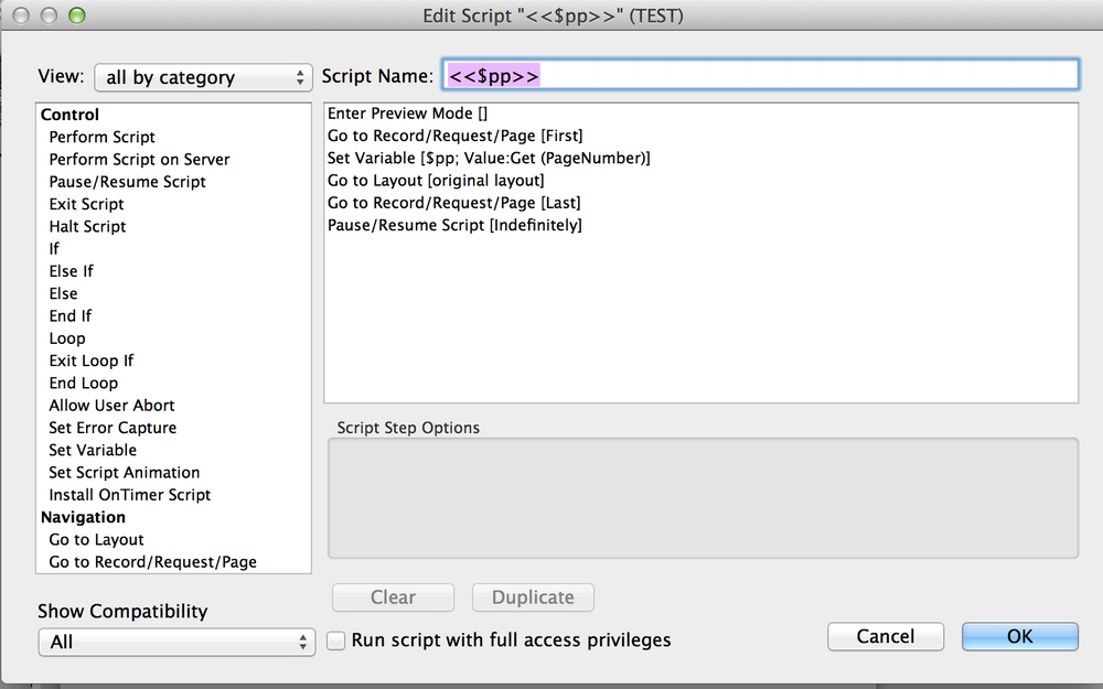

Hi there,
Thank you for your prompt reply and thank you Lee but the following was already typed when I saw your answer above.
I would like to get the page numbers on each layout with the correct total of page for each layout (instead of total record number).
For instance:
Layout 1: has 2 pages, once printed it will be written:
"Page 1 of 2" then "Page 2 of 2"
Layout 2 has only 1 page once printed it will be written:
"Page 1 of 1"
So here it's what I have done:
1. Clicked on "Edit Layout"
2. Then "Insert" > "Merge Variable"
3. Named variable: "Page {{PageNumber}} of <<$pp>>"
4. Right click > "Button Setup" > "Perform Script" > "Specify"
5. "+" > "New" then Script Name: "<<$pp>>"
6. Then I create the following script:
  • Enter Preview Mode [ ]
  • Go to Record/Request/Page [First]
  • Set Variable [$pp; Value:Get (PageNumber)]
  • Go to Layout [original layout]
  • Go to Record/Request/Page [Last]
  • Pause/Resume Script [Indefinitely]
Then I click on "OK" - I make sure the script selected is the good one then I click on "OK" again.
7. I exit "Layout mode" and I can see where I have inserted the "Merge variable" the following: "Page ? of       "
8. When I put the arrow/mouse over it + click, I enter the "Preview mode"
9. then I can see on the 1st page of my Layout 1: "Page 1 of 1"
and on my Layout 2: "Page 2 of 1" > which is incorrect. It should be: "Page 1 of 1"
The number of page should be reset/different for each layout.
10. If I click on one of my button, previously created to get a Pdf of one of my layout the following appears: "Page 1 of      "
The end is blank.
11. OPTION 2:
I have tried something else -
If I write this text: "Pg. {{PageNumber}} / {{FoundCount}}"
Without using any formula it will do the following on a Layout which has only 2 pages:
On my page 1  it will be written: "Pg. 1 / 3"
And on my page 2 it will be written: "Pg. 2 / 3"
The number "3" = the number of Record I have for this type of layouts.
I would like to change/get the formula when "FoundCount" equal the total of pages on each layout.
Thank you so much for your help and I'm sorry about this long explanation. I hope it all makes sense. It is so easy to do in word and excel. At the end: I will master Filemaker Pro :) !
And Here is the pic.
I think I have to ask the software to look at the layout instead of "record".
Thank you
We are going in a circle here. You need to change your script so that it does:
Go to Layout [ **your print layout** ]
This is assuming you want the same script to put user on page 1 in Preview mode. Note also that the $pp variable will be deleted once the script runs out. If you want to retain it, rename it to $$pp (and adjust the text on the layout accordingly).
With regard to the text on the layout: when you click into it (in Layout mode), you should see exactly this:
Having written all this, I now find that the help has the same script and merged variables example:
http://www.filemaker.com/help/15/fmp/en/#page/FMP_Help%2Finserting-merge-variables-on-layout.html

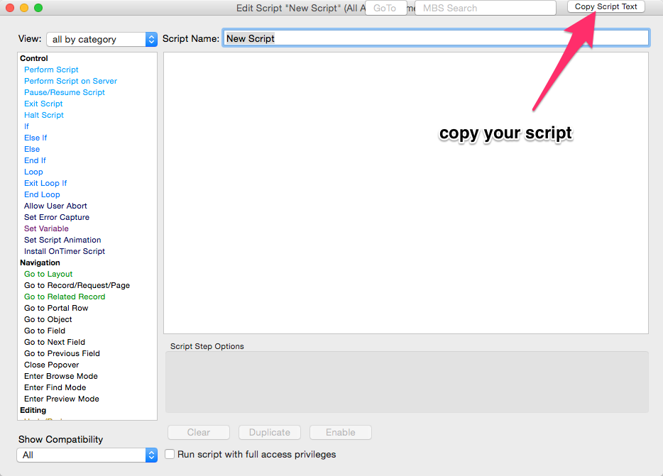

I didn’t want the Screen Shot, I wanted the Text.
Hi Lee,
I wanted to copy and paste but I am unable to do it on Filemaker Pro 13. The script window do not look like the one you have and I can't copy/paste into a text editor.
Wow, that’s weird?
Anyway, you can always print a script to Preview and then copy that. Don’t bother doing that now though.
