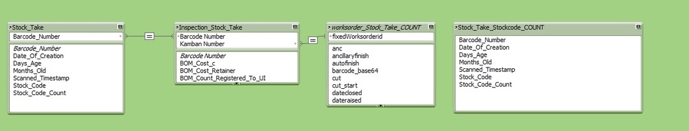

Here's a screen grab of the layout.
field -'fixedWorksorderid' is the Works Order Number.
(Edit to add: in this grahpic, Stock_Take::Stock_Code and Stock_Code_Count are empty fields i'm trying to propergate.

But overall, I find your diagram impossible to understand without more detailed description.
A Kanban (storage location) related to a work order ID? What?
There's no relationship... because there's nothing to relate it to... there's no matching field between those tables; all the data is there, but not in the one table, that's my problem. I can't get my head around how to fix it. I need to link the two together so I can count the totals from our Stock Take. A self join of Stock Take.
To explain, the image is a set of several TO's used in a much bigger FM system. We are manufacturers, primarily, the concept of Kanban/Kamban is used in that arena and can basically mean a 'works order'. The differences are crucial at a detailed level, but not here. The 'worksorder' table is from an external SQL source and its schema is modelled on another external ODBC system - Sage 50. We've moved to SQL Sage 200, so we have a rolling program of standardising the schema which is working. It's a lot better than it was, shockingly!
'fixedworksorderid' is the 'Works Order Number' that is given to the record.... It's part of a scheduling app on our SQL we wrote to 'suggest' a list of Works Orders (in Kanban order, but lets not get into that). So the 'Works Order Number' would actually be a floating point that changed based suggestions and only until a human called for production and set in motion the WO, did the 'fixedworksorderid' field populate with something like '12345' or '12346' or '12347'.
Well; for me; completely incomprehensible.

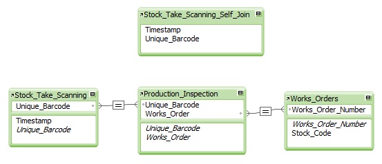

Here is a replication of the tables with the labelling (table labelling, not physical product labelling) simplified. I've also taken out the fields etc that don't apply.
Sorry this wasn't done before. The last time i presented this board with simplified TO's in a diagram, i was asked to provide the full information, with all the other fields contained so that the posters could make sense of it.
What I'm trying to do is get a count each TYPE of Product in table 'Stock_Take_Scanning', designated by and grouped by 'Stock_Code'. I would need to self join to Count, but the Stock code is only available in table 'Works_orders'
I feel like I should have a field in 'Stock_Take_Scanning' called 'Stock_code' that is a CALC field that equal something like 'Get(Works_Orders::Stock_Code)' and it would just relate through, then i could attach the Stock_Take_Scanning_Self_Join via the Stock_Code and it would COUNT.

18 hours ago, comment said:
Now, you say that each stock item has a unique barcode?
16 hours ago, Harry said:
Yes, each StockItem has a unique barcode.
Or do all widgets have the same barcode, and all gadgets another one?
Each Product has a barcode. Products table would have two Barcodes in it. StockItems would have two Barcodes in it, attached to the two products.
Or,
We make 100 x Model A and 100 x Model B. There are 200 'unique barcodes', 2 'product barcodes'.
Each Product / SKU has two codes on it. A Unique Code, and a Barcode.
If the barcodes are unique, you need to tell us how one can tell from reading the barcode if the product is a widget or a gadget.
And you recognized, I hope, that your answer was then and still is so confusing that Comment, who is ENORMOUSLY capable of unraveling complexity, gave up after your "explanation".
And now you have just confused things further.
I recoginse that it's not explained fully, yes. I have stated that and then further asked for clarification on which questions weren't answered. You keep replying by telling me that it's not comprehensible. But of course, without knowing which bit is incomprehensible, I cannot try to communicate it in a less complicated fashion. Indeed, I tried, but it only served to further complicate the discussion. Therefore, as is obviously the case that my entire description and subsequent answers to critical questions do not serve to enlighten you and Comment, it is not unreasonable for me to suggest that smaller parts are discussed and agreed upon, rather than trying to communicate the entire problem. So i tried to take it question by question, you've stated that I'm not answering the question.
Although I see that the answer is confusing, i do not see how. I apologise.
How has my answer, above on this page, confused things further?
I've taken each individual question that Comment has asked and answered it fully, while still briefly. I understand there's confusion, but I can't see what I've written that is so confusing.

Ah, right, now *you're* making sense to me.
Sorry the post wasn't formatted correctly; yes that was a reply.
When I say 'Product', and not in reference to 'Table Product', I'm talking about what you talk about as an Inventory Item. Yes. An actual product thing; something we make or sell.
(Which brings a very interesting question - when I say 'Product', what are you thinking about, if not a product....?)
Anyway, to (hopefully now) clarify.
An Inventory Item has one Stock Code.
An Inventory Item also has  one Barcode. The Barcode is a unique serial number designated to that particular individual instance of that Inventory Item, whether physical or not. Like a Primary Key, they are never repeated.
The Stock Code gets repeated and is shared amongst all the Inventory Items of the same variation, or SKU or Product Code or Stock Item or etc etc. All '15m Green Hoses with Nozzle. have StockCode 'SAME'.
And not to confuse things - but the stock code is, yes, represented as a barcode, too. in a lot of the system it's called 'Barcode' or similar....
That's why i don't put the file up; i'm not allowed to post it and it's quite confusing.
Regarding possible ambiguity of "Product": my meaning was as in a Product table: SKU, description, price, etc.

@Harry
I suggest you take a look at the attached demo. It has three tables, which I believe are more or less equivalent to your three tables:
  • the InventoryItems table is what you called StockTake;
  • the Units table is what you called Inspection;
  • the Products table is where the "more or less" part comes in: in my version, ProductCode is unique in this table; if this table becomes WorkOrders, this might not be true - see the note at the end.
The purpose of this file is to show:
  1. how these tables need to be related,
  2. how to lookup the ProductCode into the InventoryItems table, and - most importantly:
  3. how to get the Products table to show the count of the product's units on the selected date.
Note that the count is by ProductCode. If you work with work orders, and each work order has its own unique ProductCode, then each work order will only count its own units - even though there may be other units of the same product, made under a different work order.
Note also the assumption that an inventory count is performed on a single date (not crossing midnight).
InventoryByDate.fp7
