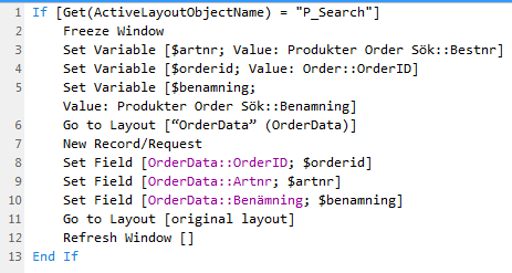

I am making a solution that I am gonna use on my Ipad. I have a script that adds a new record in the portal, by grabbing the ID from the table the portal is on and then going to the related table and adding the data to a new row there.
That works fine, except for one issue. The Ipad screen flickers, even if I use the "Freeze Window" script step. It does not flicker on my PC.
I have taken a screenshot showing the whole script, note that soame of the table names are in Swedish.
Is there another way to add rows to a portal or is there a way to stop the flickering on the Ipad?

Problem are now solved.
The flickering is now gone. The only thing that flickers now is the button that activates the script, but think it's the button itself that does it. Have to check the settings on the button for that.
Anyhow, what I did was this:
I moved the "Freeze Window" step down below the "Go To Layout ["OrderData" (OrderData)]" and removed the "Refresh Window []" on line 12.
This stoped the annoying flicker evrytime I pushed the button.
