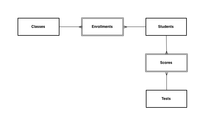

I have no idea what "class line item" means. Based no your description, you should have the following structure:
Now, in order to produce a report similar* to the one shown earlier, you need to:
1.  Select a class for the report and find the scores of the students in the selected class. You did not tell us how you want the user to select the class; for example, the user could click a button in the Classes layout, and your script would then find the related scores by doing Go to Related Record[]. Or you could just perform a find in the Scores table.
2. Sort the found scores by StudentID, TestID and by Score (descending) and show them in a report layout (based on the Scores table) having sub-sumary parts for StudentID and TestID and no body part. The Score field would be in the sub-summary by TestID part.

so i need to delete the existing relationship of the database, right?
(*) Note that Filemaker's native reports are vertical, not horizontal. Taking your earlier example, the described report would look something like:

If i would like to use class table to show the maximum score and the related test date, what should i do?
I don't see how that's possible using Filemaker's relationships. It may be possible using ExecuteSQL(), but I am not going there. I recommend you learn to use the native reporting methods before expanding to SQL.
