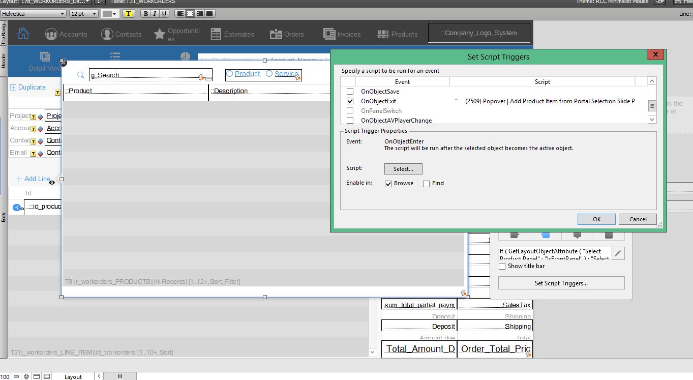

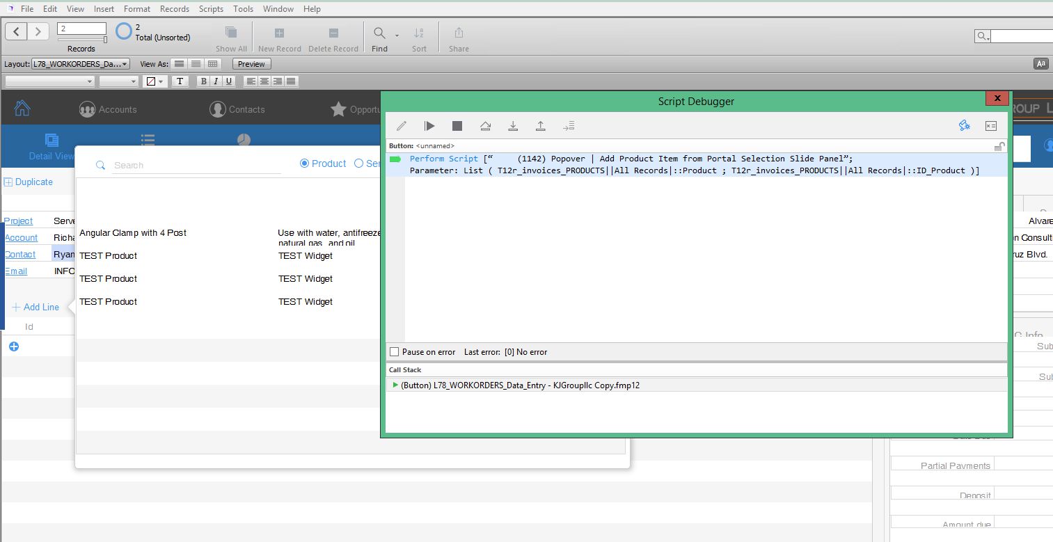

I'm using FM Starting Point and duplicated the Invoice "module" (layout with tables, tos, etc.) to create an Orders "module".  I dutifully went through and changed the fields, relationships, scripts, etc. etc.  However, when I click Add Item and the Popover Button appears, when I select a product it is not being added to the order.  So I ran the debugger while going through the process and the debugger shows that the old OnObjectExit script (from the Invoice "module") is being called for.  I double checked all the scripts and TOs and everything and all do indicate they are the correct new ones I created (by duplicating the Invoice ones) for the orders.  So why is it still calling for the old script?  And how do I fix it?  I tried clicking Edit Script in the Debugger but it is grayed out when running the Debugger.
Does the popover have any script triggers attached? Specifically, OnObjectExit.
Yes it has an OnObjectExit set to trigger a script.  The problem is when I run it through the debugger it is bringing up a different script. I don't understand where it is getting this from?   The weird thing is I can delete the OnObjectExit trigger and it will still call for that wrong script.  Seems something else is triggering it, I just can't find it.

So I figured it out!  It was the button that is over the Add Item Popover portal fields in the Invoices "module"...I had moved it behind the portal fields (Send Backward) when I duplicated it so that I could update the portal fields (you can't click on the fields when the button is over them).  However, once it was moved, I couldn't see it and basically forgot about it.  There isn't any little script icon attached to it either, so I was forgetting about it when I made all the script changes.  And even though it was under the fields, it was still activating.  Once I figured out what was going on, I found the button underneath the fields and was able to fix the script and the parameters. BOOM! Works like a charm now.
