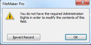

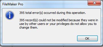

I'm getting the attached error messages when trying to modify records in a file. It's appears as though there is some protection in place, privilege sets etc, but there isn't and never has been. I've tried recovering the file to no avail, is there anything else I can try? I haven't accessed this file in approx. 6 months, but have never had issues before and I'm the only user of the file.

The first dialog is a field validation setting, not a security setting.  If you know what field it is, go into Define Database and check the field's options and change it.

The field Assessors Comments has a validate by calculation on it - Get(UserName) = "fairburna" or Get(UserName) = "fusseyn" or Get(UserName) = "clare"
If you're not one of them, you get the message above.
Great stuff webko, removing the validation seems to have done the trick.
Strangely though, I am 'fairburna' on my work PC and another thing, I only had that validation on Assessors Comments so how would it affect other fields in the same table?
If you log in to the the database without credentials, then you are not as far as the database is concerned....
And it affects that field, and the record - as that field is set to validate, if it fails then no change will be made to the record.
