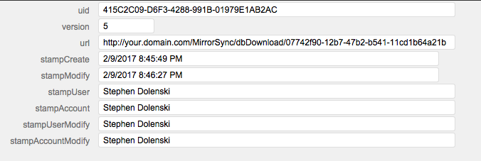

Step 1: Create a table in your solution VERSION this table will have the minimum fields of a UID | version | URL | Time Stamp Create |  Time Stamp Modify

Step 3: Add a record to this table and start the version number at 1 and copy and paste the download link url provided by the MS config tool.

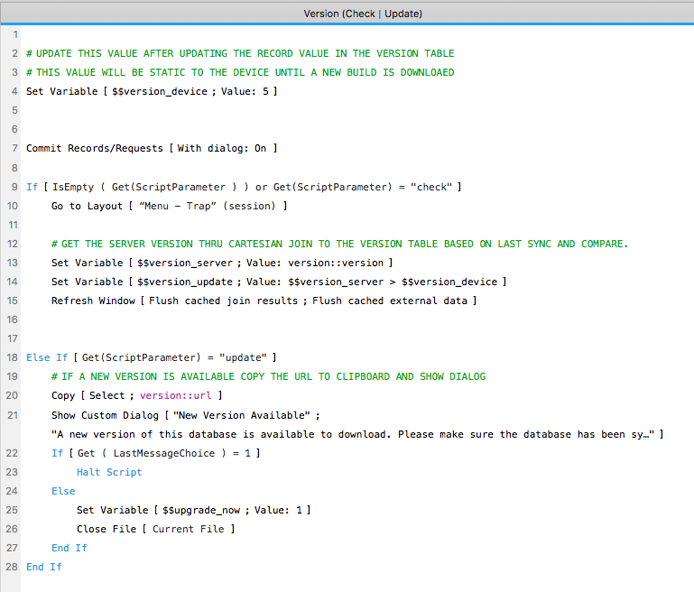

Step 5: Add a Script: Version  ( Check | Update ) the two parameters will either check the version and inform you of  a new update, and a way to copy and download the URL.

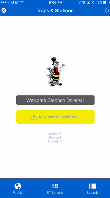

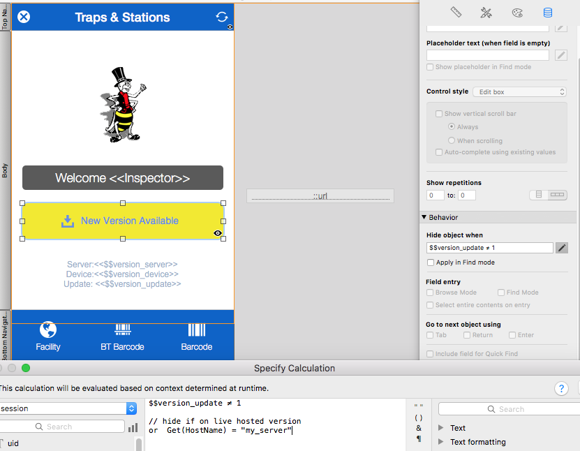

Step 6: On your main layout add a button that will hide when the variable $$version_update ≠ 1  (and also you can test to see if your not on the live version by testing of host name)

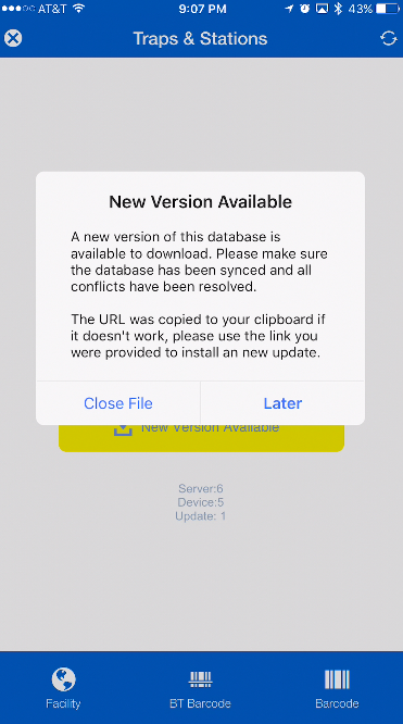

Step 7: Button passes the "update" parameter to the script that simply copies the URL from off the side of the layout and presents a dialog box to the user to close the file and paste the URL into Safari where it will download the file and replace the original.
How it works is fairly simple. When you have a new build ready, you go to the version table (single record table)  and increment the version number, then open the script and update the version number there.
When the user performs a sync they will be given the newest value from the version table - then you can run this "check" portion of the script to compare the value against  local value from their script version which would be out of sync. The end result will light up a button informing them that a new build is ready to download.
