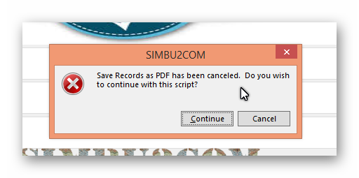

Made runtime with fm 16 advanced when running pdf output script getting following error  - some one please guide me doesnt the runtime support pdf output Ashampoo_Snap_2017_05.24_08h46m23s_001_.png.77f2a30ab4ab727618a56394afd54210.png
error
Read the link in my post above.
