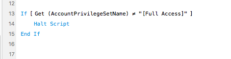

Create a Script called "Unlock Menu Bar". Make it unlock the Menu Bar and make sure it's visible in the Scripts Menu. And add a piece of code, like Wim suggested to make sure you can only run it. You can replace Full Access with your privilege set if you use something different.
Edited by Agnes Riley
