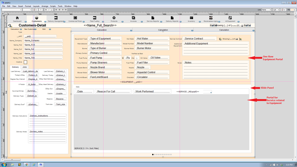

I basically have 3 tables related
Customers--->Equipment--->Service (which is service on each piece of equipment.
I thought I could do the following
On a Customer layout, I have a customer info on the left, and 2/3 on the right a slide panel.  The panels are other related tables with portals-Deliveries, Interactions, Equipment.
On the Equipment Slide Panel, I thought I could make a large 1 row portal (on the top) with all the Equipment attributes (looks like a regular layout), and a multi row portal on the bottom with all the Service info for that piece of equipment.
Then, as I use a button to go to the next portal row in Equipment, the Service portal would change to show the related records.
Many variations of relationships and TO's did not work for me.  I can provide more detail and post a file if someone thinks it a workable solution.
Steve
I don't understand your description.  A customer has many pieces of equipment - so which one of these should the one-row portal show? And what exactly is "the next portal row in Equipment" you speak of? A one-row portal does not have a next row.
If I understand the general purpose here, you need to select a specific EquipmentID and store it in a global field or variable. Then you can use this either to filter the portals to Equipment and to Services (provided the number of related records is not too large), or as the matchfield to be used in auxiliary relationships to new occurrences of the Equipment and Services tables.
Thanks again :) for responding.
Your understanding is exactly correct.
The one row portal is probably not the right descriptions.  It's showing one row.  The < > arrows in the portal switch it to the next portal row.  Unfortunately it appears I have to allow scrolling, which isn't what I wanted.
Plan 2 was to put the exact same copy on different slide panels.  Each successive panel would look identical, but the equipment portal would only show 1 portal row-increasing the portal row number by one (showing the second related equipment record).  But I was unable to get the lower (Service portal related to that Equipment) record to change.  I think my problem, which you pointed out, was trying to do either option off of the same relationship, and not grabbing the ID in a variable.
I think you put me on the correct path.
Thanks for your guidance.
Steve
Is this a good idea? I think that as a user I would prefer to select from a multi-row portal (or at least from a pop-up/drop-down), rather than navigate blindly to the next/previous item.
I don't see why. If you really want this, just set the filtering variable/field to the next/previous EquipmentID in the list of related equipment IDs.
That is most certainly not a good idea. Slide panels are designed to divide the layout's real estate to various areas of interest, not to show individual records.There is no way to dynamically adjust the number of panels to the number of related records.
