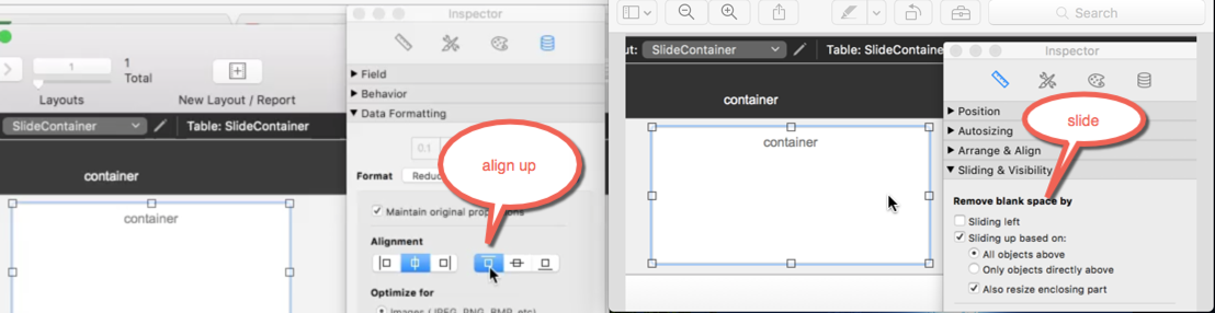

Hi Chris,
For containers to slide,  you must set the the slide properties AND set its alignment to up (or left as needed).  Please view these two settings in the attached screenshot.  Also note that ALL OBJECTS within the part you want to slide ( in this case the body ) must have the sliding set, including text objects or lines.
Also note that sliding only works in Preview mode.
