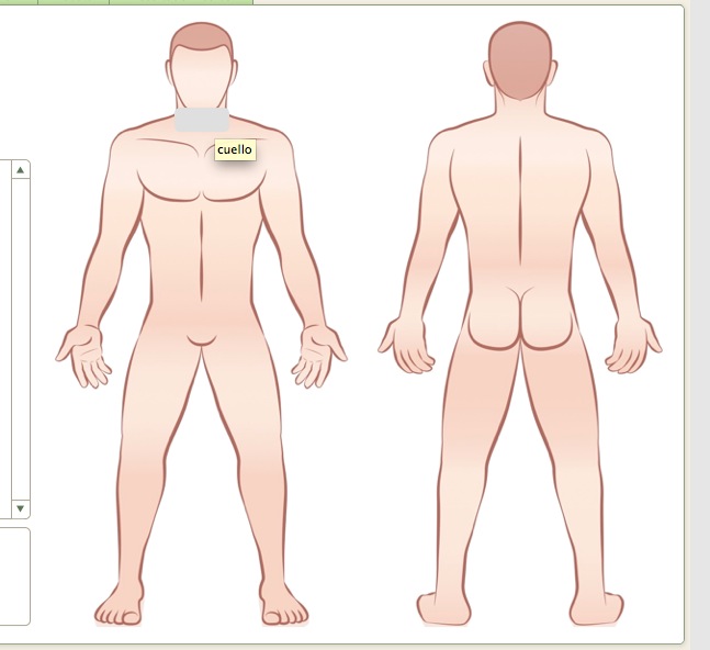

Use Case:  I've got a graphic (in this instance, a complete human body).
I want to mouse-over and click on say, the hand, and have that trigger a script, with a parameter.
I'd hope to simply have a single script, read the parameter (which would in fact grab the value of the tooltip), and have that passed into the script.

Yes.... this is a graphic of a human body (medical db for a specific sub-field). imagine a stickman... we've created a clear object which overlays the hand, another over the wrist, the arm, elbow, shoulder, thorax, etc... ~50 such on the front,a nd another ~50 on the rear image...  then there's the second gender.....  so, 200 objects.... :D
the use case is that when the user mouses/hovers over say, the left wrist, he sees a tooltip, saying 'left wrist' (in his language).
The click would then pass "left wrist" or "male left wrist" into a single script (which is able to parse where to take it and what to do with it)...
The issue is that we can't seem to get "wrist" (either tool tip OR the Object Name) to pass properly into ANY script on click...
GetLayoutObjectAttribute seems to require a name - but we need to capture the name..
Our hope was to create only a single object, prepare it, then duplicate it, and have to change only the location and objectname (or object tooltip), in order for the script to capture that value for use in scripts.
But it seems that our only found method is to 1. modify the item and tool tip, and 2. click into the button setup, and modify the "script parameter), then pass it on into the actual script.. As this process will be replicated 200x's for adults and another 200x for children, we'd really like to avoid the mind-numbing part of bumping thru EVERY SINGLE SCRIPT PARAMETER....

Yes, and I also should mention, for others reading even if not your situation ... hard-coding values normally isn't a good approach.  If those names will be used as record data or elsewhere, it might be worth it to store the part names in a table with only a unique auto-enter serial number and referencing its text from the relationship in the tooltip instead.
Anyway, I can tend to overthink but I thought it good to mention the dangers of hard-coding values.  I envisioned this might be the only place you would need to change the name but if the scientists decided that a cuello should really be properly named a cou and you had used cuello all through your solution, it would require a substantial cleanup whereas if the parts were in a table, you would just change it in one place and use its Serial all through your solution.
This is something that might be easier to implement in a web viewer, I think.

We were able to meet with the medical reference team for 2 hours last night, and because we could update this with a simple modification of only tooltips, we were able to make all modifications on-site, verify with them in their language, and even fixed additional components.. wouldn't have been possible without this tooltip value script - we wouldn' t have had the time to pull it off..  in 2hrs, we went from 1 human body correct to all 4 forms (2 adult, 2 child) - well over 400 total reference points...
