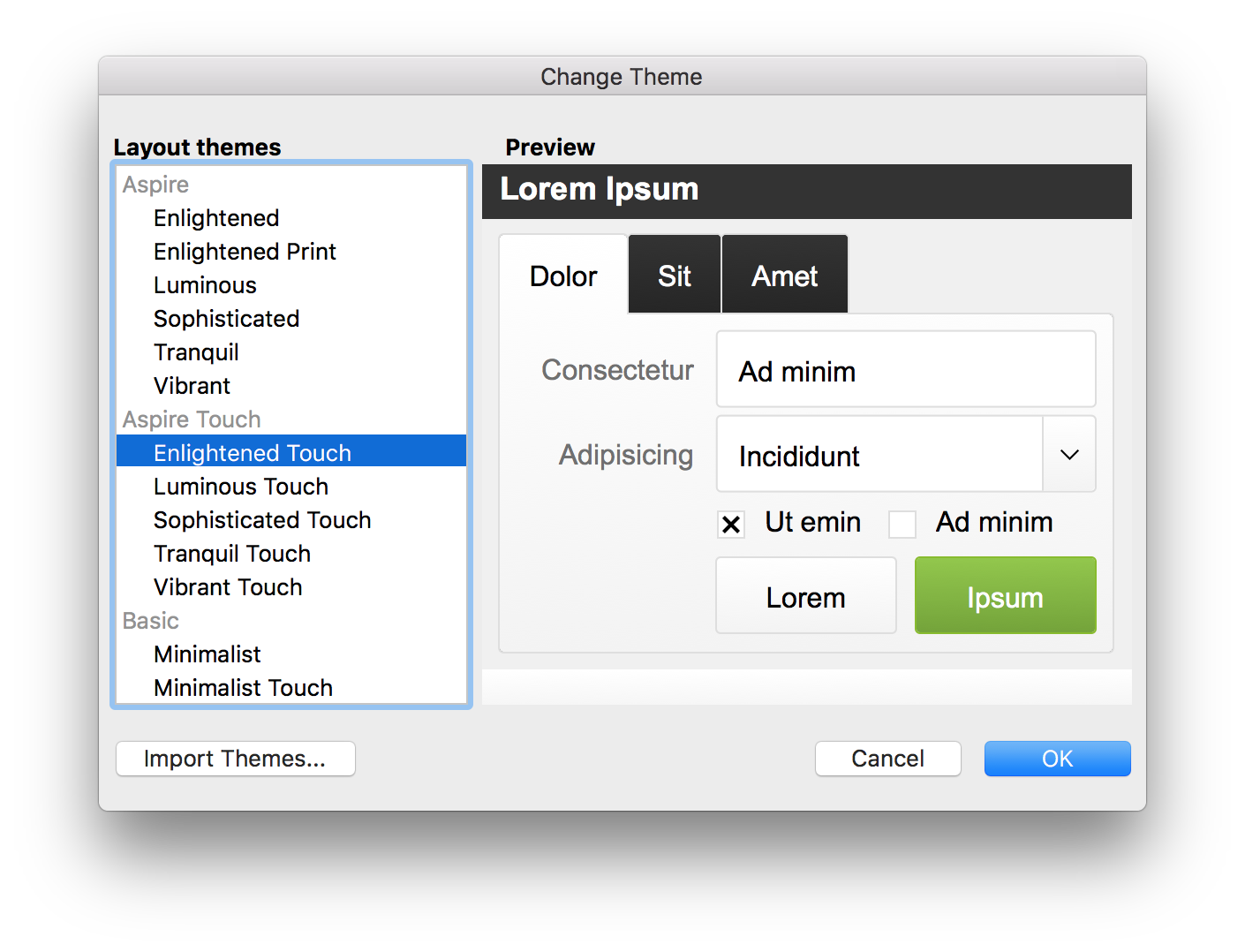

1- Create a layout with the theme of your choice for Touch.
595d744424c79_ScreenShot2017-07-06at2_20_21AM.thumb.png.544e7d044980fc1df919f8c46fd95569.png

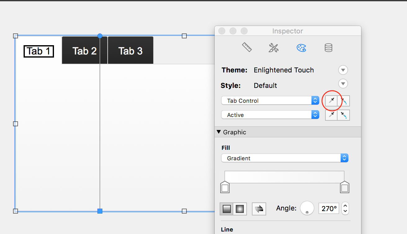

2 - Create a Tab Control
3 - Copy the Tab Control Tab from the theme for touch.
595d7302e3703_ScreenShot2017-07-06at2_12_40AM.thumb.png.eb3dce5e21eebe8c05a71a38366152b4.png

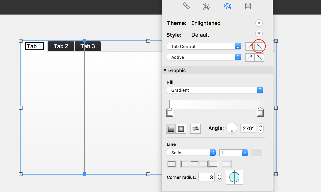

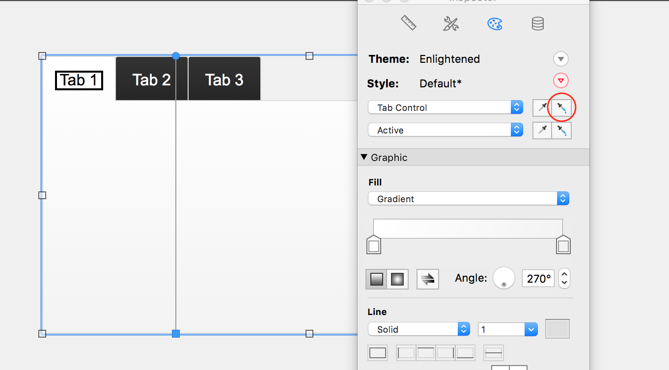

4 - Go to the layout with the theme for Desktop
5 - Create a Tab Control
6 - Paste the style to the Tab Control... The tab becomes like the one for Touch.
595d74ac0bf30_ScreenShot2017-07-06at2_21_30AM.thumb.png.01c53704eccd6d2de0f4895a35c08303.png

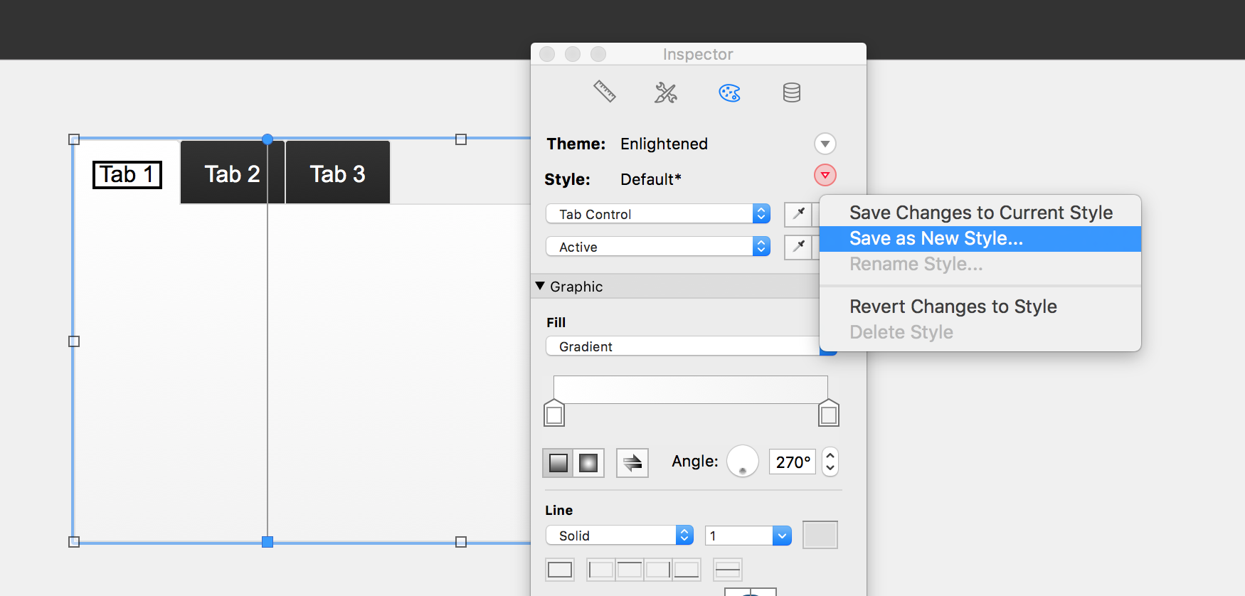

7- Save a new Style... and Voilà.
595d73db4d596_ScreenShot2017-07-06at2_13_32AM.thumb.png.7f51c1aec66546b17453dd24ff7f3bec.png

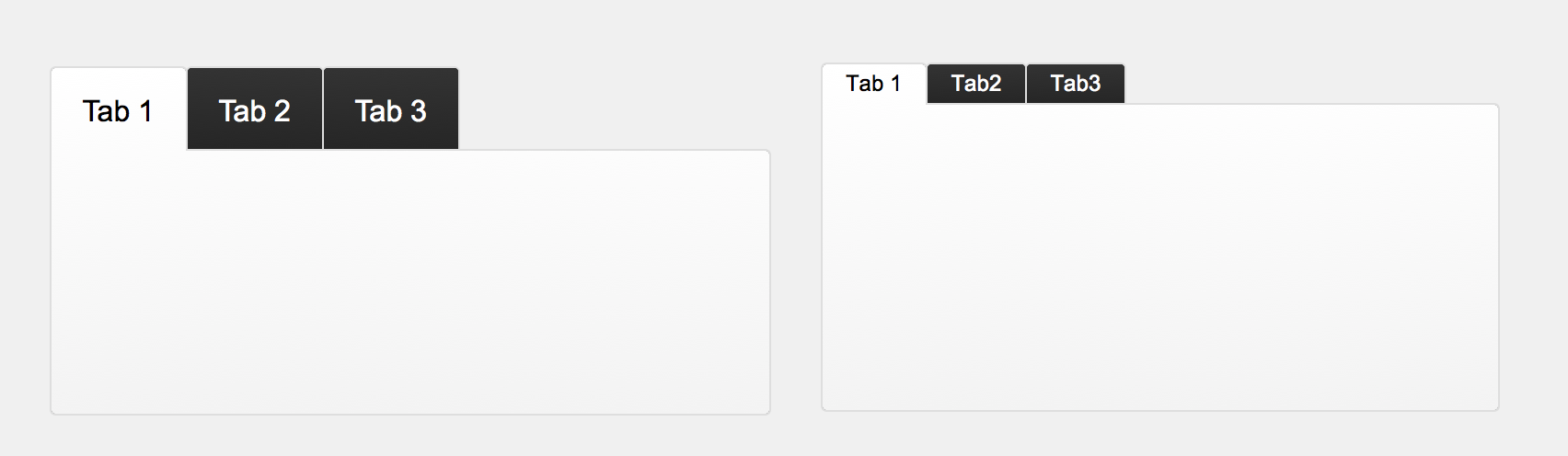

You have now both Tab Control in the same layout.
595d73ea1eb56_ScreenShot2017-07-06at2_18_06AM.thumb.png.8cf891f6d3c47b8eb3fa51b1ede16f01.png
