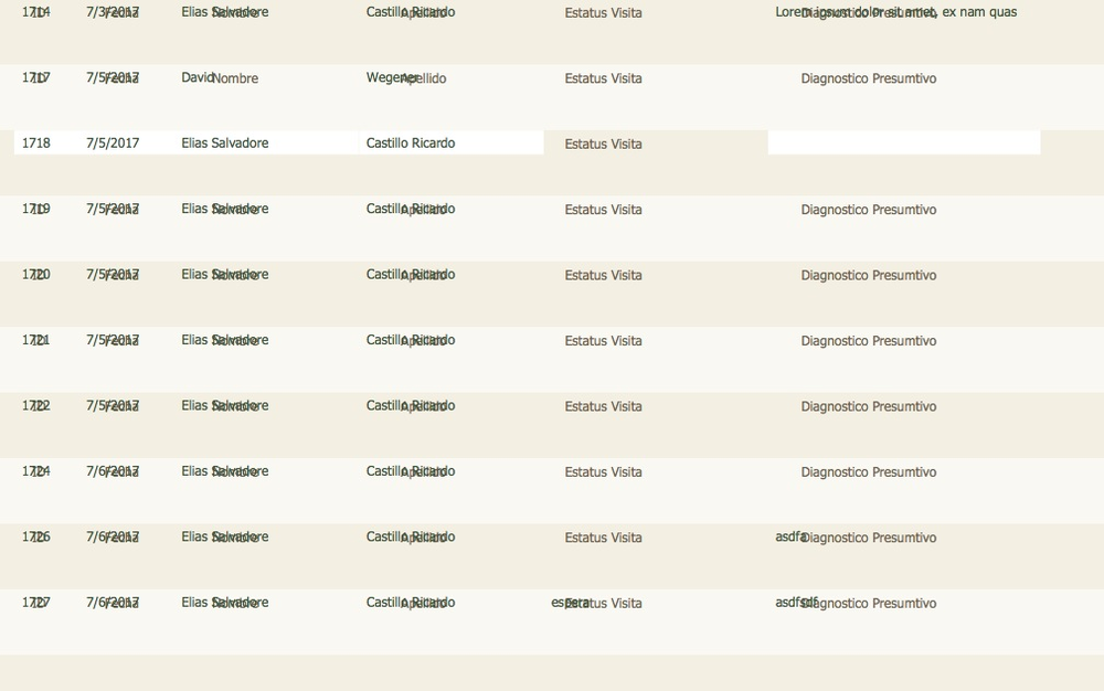

I sometimes use a trick in Conditional Formatting to give fast hints in form views..
i'll place a merge field (name of field, or helpful hint) BEHIND the actual form, then will format the field to have a clear/no backcground, using a calculation of "IsEmpty(Table::FieldName) - to trigger it..
So if the field is empty, the hint is visible, but if there is any value in it, the hint disappears.  See screenshot below..
The problem is that this falls apart in List View.. active fields work.. inactive don't.. what ca I do?

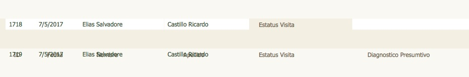

Sorry -- thought this would be pretty self-evident..
In the image below, the only list row which is showing PROPERLY is the one that's selected (ie., the backgrounded text is completely dissappeared, as the conditional formatting is working on that record and they're actually filling in...

Well... in trying to show this properly, i found a work around..
using an "IsEmpty" seems to NOT work on a list view for items which aren't the current record.
but....
"not IsEmpty" **DOES** work....  so i have to just flip the command (leave field blank, but if it contains something, then make it fill)...

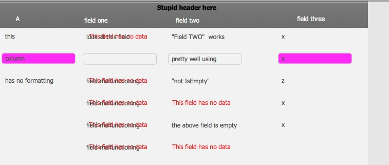

here's a shot now with it configured the other way (text fields in front are 'No Fill' , and mergefield text is formatted normally but if field is "not isempty(table::field)", then the text is clear and the fill is clear..
Edited by wedgeman
attached..
column 1 and 4 have no format.
column 2 has format as shown in my work around (which works), but column 3 formtting does NOT work..
it appears that "isempty(x::xx) does NOT work in lines, but "not isempty(x::xx)" DOES work...
Am I missing something?

You're correct.  It seems we're having a communication issue.
1. Ignore the missing field.
2.I INTENDED to put labels behind the fields, in order to show the problem.
The problem is that conditional formatting doesn't all work properly on fields shown in list view. It appears that it (conditional formatting) only works properly on the ACTIVE RECORD in a list view, under certain circumstances.
See the attachment.
Column A, and Column Three are unformatted.
Column 2 ("field one") formatting works ONLY WHEN the current record is highlighted.. it doesn't format properly on other records (in list view). This is formatted using "IsEmpty" calculation.
Column 3 ("Field two") is formatting properly..  it is formatted in reverse, using "not IsEmpty" calculations.
