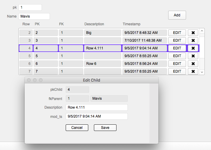

Delete that script. You don't seem to have actually followed the suggestion. See attached.
portal row edit.fmp12.zip

As recommended by Comment: in the original window, do not ever leave the original layout.
Open a NEW window. Do what you want there. CLOSE the new window when done.
Get to this new window however you want.
You said you did this. It is obvious from your reply that you did NOT.
