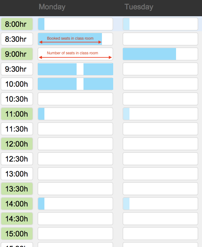

Hi Lee - that is sort of what I am after but the axis would be switched. Here is a screen shot of what I am after.
If I can get the custom function to work I think I can achieve my aim using a related table and conditional formatting. The table of times lots ( screenshot) would be referenced to the Custom Function in the actual timetable (previously attached file.)
Also the timetabling is actually quite complex as more than one class can occupy the space at the same time, hence the two sectors in the 9:30 and 10:00 time slots.
