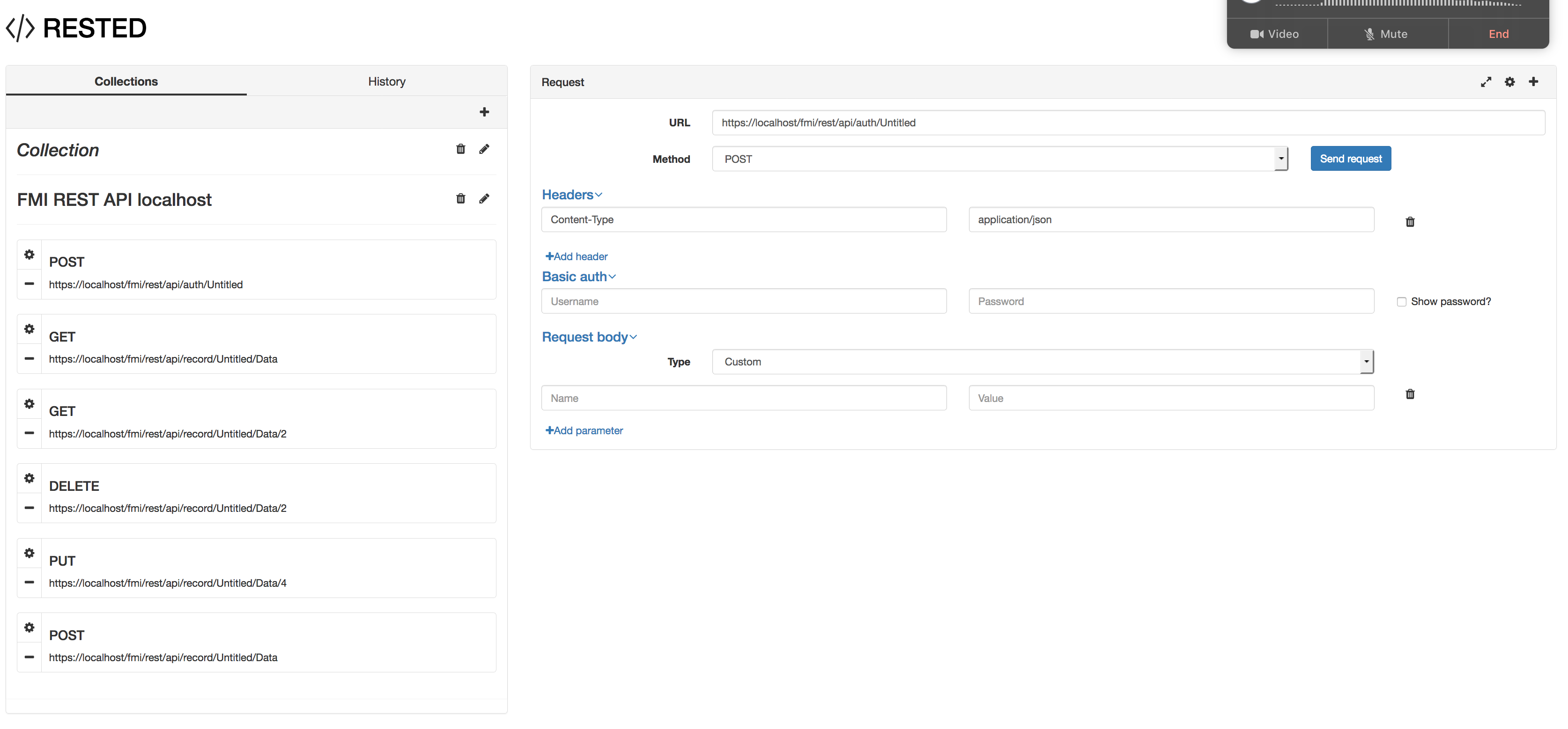

I do recommend to use FireFox </> RESTED-addon to make your queries the first couple of times so that you know which pieces of data you are to work with. Further I would not use jQuery, rather use Angular, vue, or react as the latter 3 are for HTML5, jQuery I have not used since XHTML/HTML4
 Thanks for your help. I added the plug into Firefox but I’m not sure how to get it started. I don’t see any rested menu choices in Firefox. I also could not find any documentation on how to get up and running. Can you provide any insights?
 Also if you could comment on the  HTML page I provided and let me know why that is only producing a white page and no console activity or anything I would greatly appreciate it
