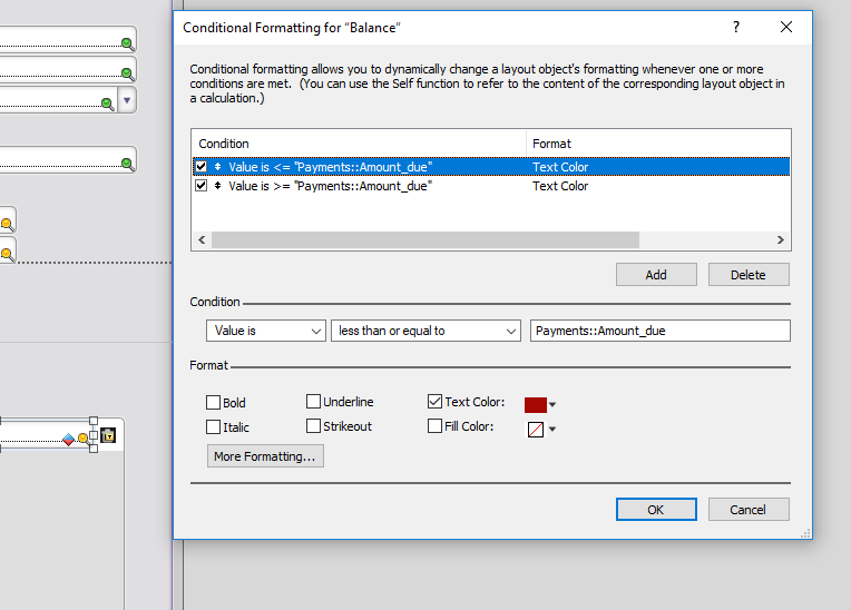

i am using my phone i dont have internet in my house yet. ok here is what i did:
i right click on the balance field click conditional formatting, click add, in the condition section
value is less than amount_due
fill color red
another add
value is equal to amount_due
fill color green
after i hit ok it fills the field with red wether it is less or equal.

Try changing the operators from the "Equal to or" to just the  Greater than and Less than.

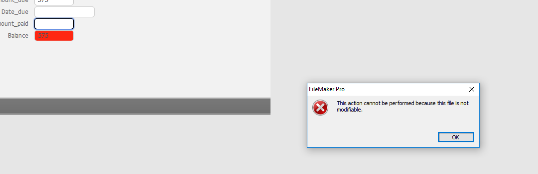

i couldn't see the conditional formatting every time i click i get this error . can you write what you did?

i can't do anything with the file it gives me error "that i can't modify it". :(

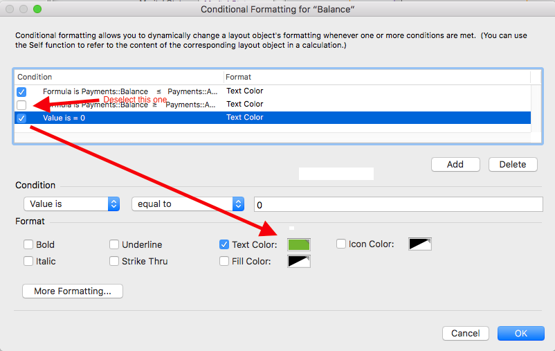

Part of it works. what about when the balance is equal to the amount due should be green?
Can you please post a screenshot of the formatting box? so i can see what you did.
Open the Conditional Formatting on the balance, and change the the purple (the color of the text in the rest of the layout) to Green.
it worked :) Thank you Lee Smith.
