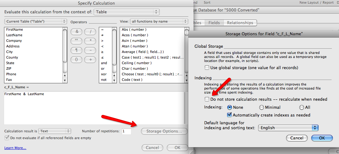

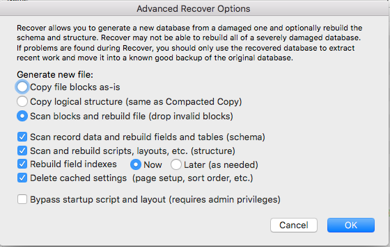

If it is an Index problem, you can turn the Index off for the field, Go into Browse Mode, and then return and reselect the indexing options. Storage Options.png
https://fmhelp.filemaker.com/help/16/fmp/en/#page/FMP_Help%2Frecovery-options.html
