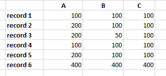

Im trying to write a script to select unique records from a table (see below). WIth no result :( . On this particular example script should select only records 1,2,3,6.

In "table view" I want to see displayed only those records. In FileMaker world you call it found set?
Is there any other commonality beside the amounts in 4 and 5 being the same as 1 and 2,  other than being the same amounts?
No.

Concatenate the fields that you determine need to be unique. A&B&C  then a self join relationship that test for the Num = Min ( showUnique::num)  will always show 1 if it is the first one of any duplicate records.
Find 1 in the isUnique field.
this method does require schema change (fields & table occurrence) a complete scripted method is possible too.

I read about self join relationship method. However, I'd like to learn to script this.
I added calculated filed with A&B&C. I watned to check record against a previous one and flag it in "duplicate" filed.  But it wont work if the same fileds are not one after another.
