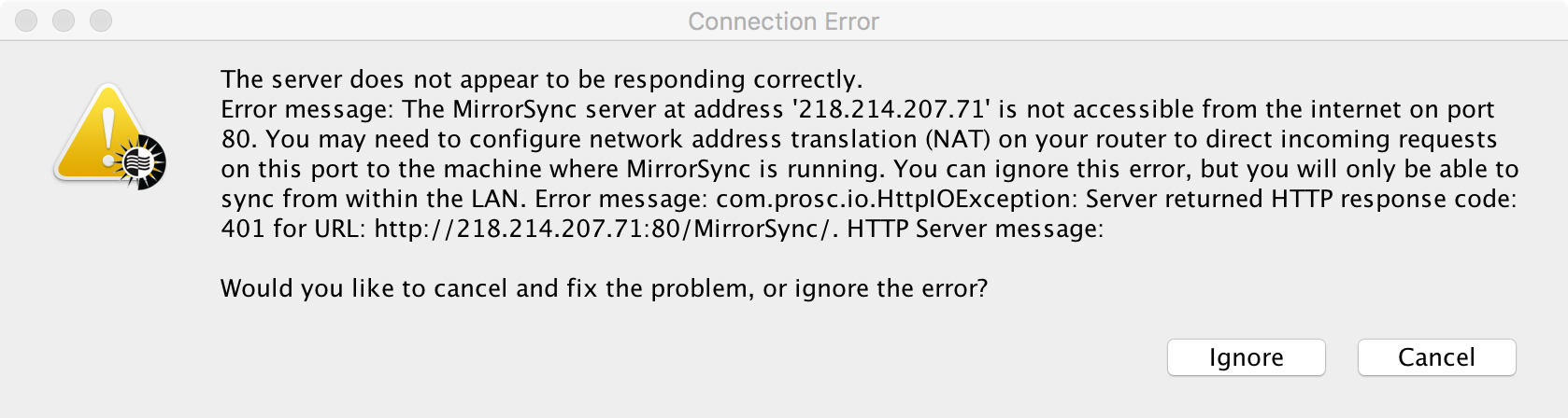

I have been having major problems after installing FMS 17 and the new MirrorSync.  First, it said web server was not running.  After hours of searching, I found that I needed to forward port 42424.  Now I need to reconfigure the Mirrorsync configuration file.  I have the IP's set as different and they are correct but MirrorSync is saying that the MirrorSync server at the IP address is not accessible on port 80.  I had this same problem with FMS16 and I got around it by selecting port 8080.  Now, we can't do that!!!
How am I supposed to get MirrorSync running like this?
