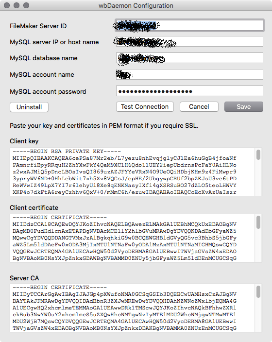

BTW, I have created a new version of the WBDaemon Config app, that CAN use SSL to connect. Setting up the MySQL server for SSL connections is not what I would call "easy peasy". Here's a good article use as a guideline: https://serverfault.com/questions/783861/enabling-ssl-in-mysql-when-using-windows-as-a-server-and-client . My MySQL test server runs on a Windows Server 2012 VM, so I do not have to translate this to MacOS, but I think it's probably about 99% the same, except for the paths, of course.
You have to create a lot of certificates and keys, and in the config application, you need to enter the client private key, the client certificate and the Server CA certificate.  There is now a "Test Connection" button that you can use to see if you entered everything correctly. If the 3 extra field ( actually I check only 1, lazy me ) are filled, the application tries to connect using SSLMode.
I have dropboxed the config app to @Claus Lavendt, and he will let me know how it works for him, when he has some time to test it.
I currently have no issues from the macOS config app, but - with exactly the same source code for the connection - the Windows config app is not able to connect using SSL, and connects without SSL, even if the MySQL (5.7)  server is configured to only accept SSLMode. Weird, and probably a MySQL security bug. I plan to install MySQL 8.0 to see if this fixes the problem. Or it could be a Xojo MySQL Community Plugin problem. Anyway, I'm not yet completely stuck (yet), I'll come back here when I find out what's happening.

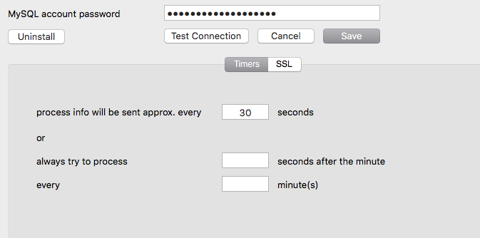

Hi Peter,
After some extensive testing (15 servers reporting) i have an issue that is realy worrying me.
It seems that the proccesses are collected continuously, not giving our SQL Server enough room to breath for other applications.
Could you put in some pause after each collection zycle, otherwise our Server wont survive the 45 Servers we want to monitor.
Right now the deamons are submitting between 100 and 350 records per second, thats hard work even for a grown up SQL Server
That would be great.
Stef
Edited by StefP
I think this something I should add in the config app, so you can specify it for every deamon separately. I think I have hard coded 30 seconds right now, and this can indeed result in peek traffic with so many daemons connected. I will give this priority. Thanks for the feedback, Stef.
I'm currently looking into this code, and I think I will implement it like this:
  • you enter the frequency in seconds or
  • you enter the number of seconds after the current minute and you enter the frequency of minutes
Even with a frequency in seconds, you can experience peak moments, once the logging timer starts to drift, which it will.
To avoid this, the logging can happen after a number of minutes, on the set second after that number. I hope this sentence is readable 🙂
You can then configure each of your daemons to another offset, and if they are all properly configured to use a time server, that should spread the load. The last field here doesn't really help spread the load, but allows you to have a greater interval than 60 seconds.
Is this approach solving things?
