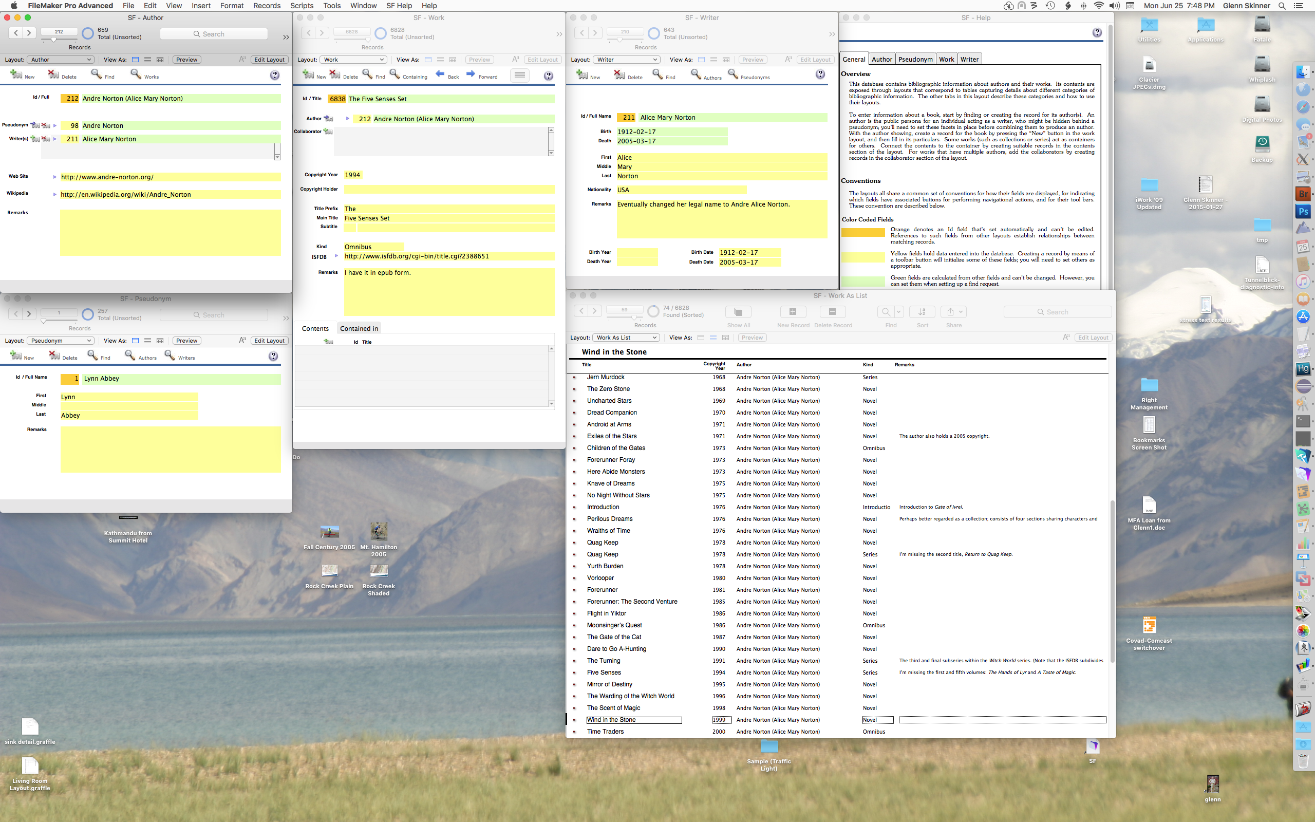

Apologies for the delayed reply.  It took me a while to distill the problem down into a database of its own.  I'm attaching couple files.  One is a screenshot of the full database in operation.  (It's a database of my science fiction and fantasy collection developed in fits and starts since the days of FileMaker 6.)  Notice that the "Work as List" window displays the found set from the "work" window.
The other is the distilled database.  Its View 1 layout displays trivial records along with a couple buttons to execute scripts. The "via PrimaryKey" button runs a script that tries to use Go to Related Record in a straightforward way to display the contents of the first window in a second window.  It doesn't work as desired.  The "via keyList" button runs a considerably more complicated script that works as desired to the same end.  It relies on a self-join of the PrimaryKey field to a global field containing a list the script constructs of the primary keys of the records in the found set.  It then uses GTTR to populate a layout with a portal that shows records from the other end of the self-join, but that displays the results in the "View 2" list layout.
This seems to me to be an excessive amount machinery to accomplish what's a conceptually simple task. So I wonder again: is there a more straightforward way to do it (without relying on the "new window" feature of GTTR)?
