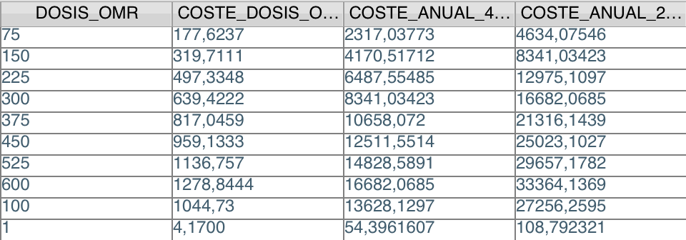

··· this is the auxiliar table, for the case you need it as a reference:
DOSE_MG
COST_PER_DOSE
75
177,6237
150
319,7111
225
497,3348
300
639,4222
375
817,0459
450
959,1333
525
1136,757
600
1278,8444

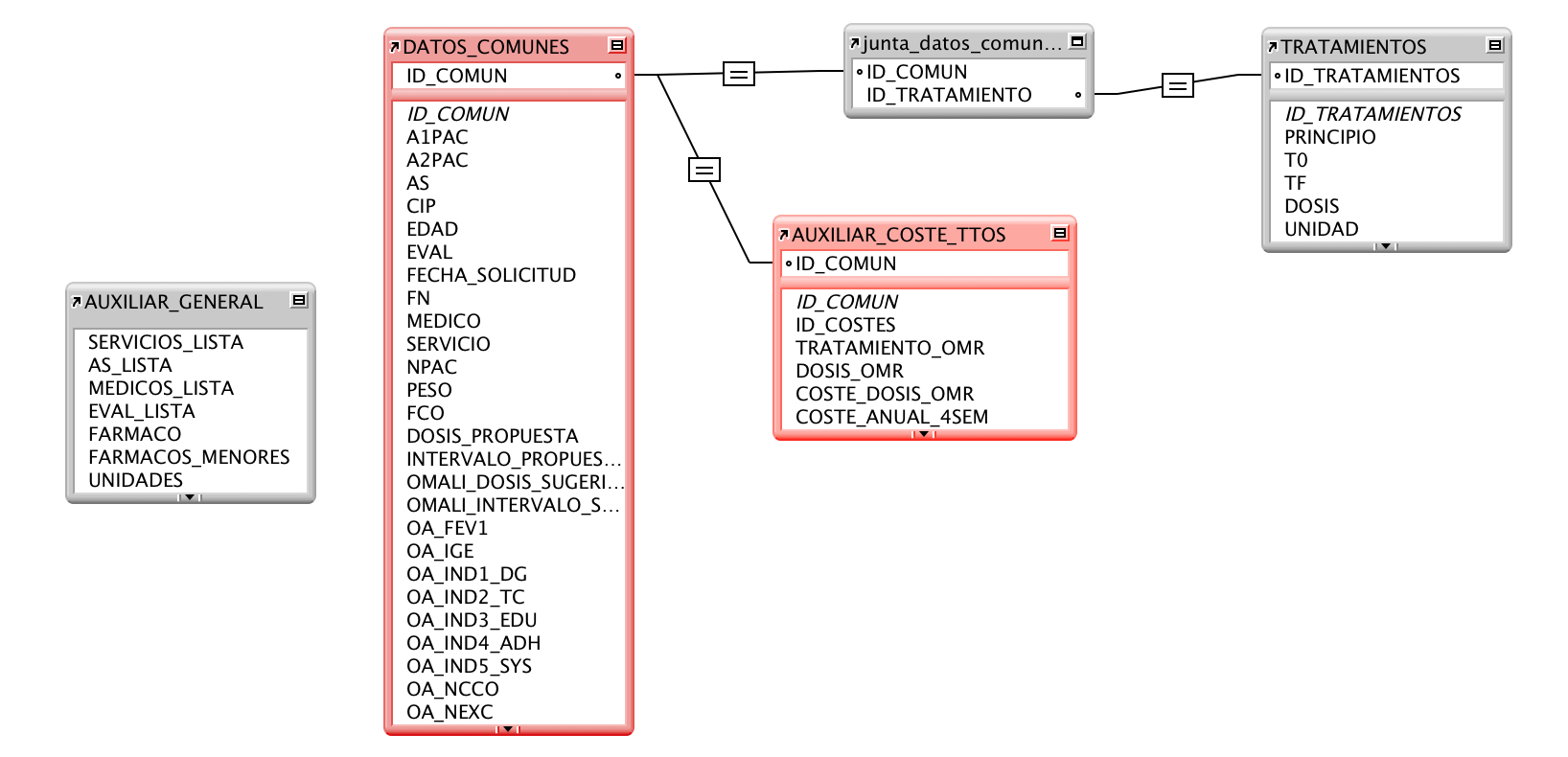

Hi again, Lee
Once again, thanks for your help! I attach a couple of screenshots of the database I'm building for my job; as you can read in my profile I'm about a rookie when it comes to filemaker. I've made some other databases, more complex than this one, but I'm stuck here with the problem we're trying to solve. Well, the information table is the little one to the right (its records are shown in the other caption), and the native the other in red. I've related both of them as you see, but I don't know if this is useful or not. I created the auxiliar table in order to be able to modify the information if drug costs change (we expect it to become cheaper with time) without needing to modify a calculation in the future (I'm the only one of my parters who know something about database creation in filemaker). Both tables are, as shown, in the same file.
Let me know if you (or anybody else) need more information!
Good night from Spain!
