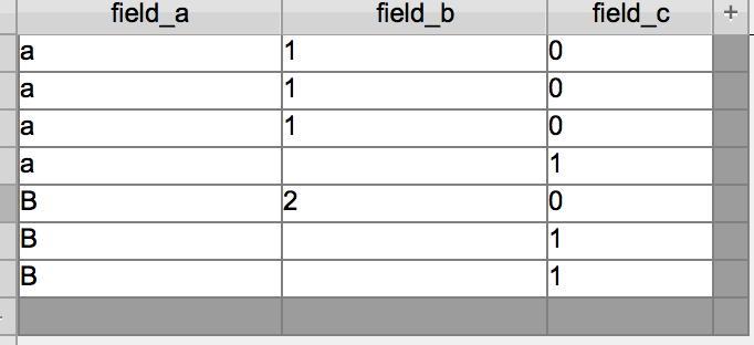

Tom, I just checked out the helpful file you provided and discovered that I'm not conveying what I'm trying to achieve.  I'm trying to get ONLY PAIRS (or trios etc.) of records that
(a) SHARE  the Field A Value
AND
(b) Have EMPTY Field B's
So in your File, I do not want to get a hit on the 'a' record with a blank field_b.
I DO want to get the TWO 'B' records
. . . in the image below, I want ONLY the two records at the bottom of the list, not the 4th record.
. . . having it laid out like this makes it easier to see why my 2-step approach isn't working . . .but I'm still not finding my way to what will work!

Hey,
Have a look at this
There is many solution to do this.
Field Field_Duplicate is the solution.
Tom
duplicate.fmp12
