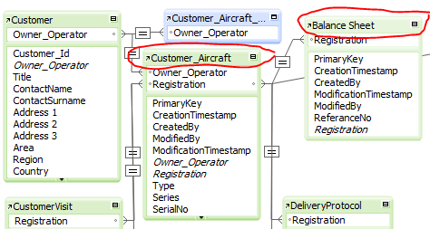

I have 2 related table.

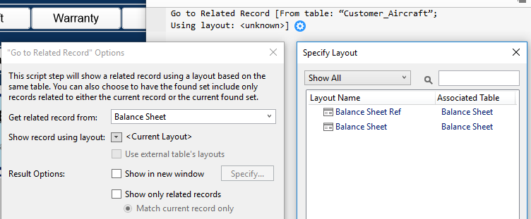

when in layout 1, i need to go to related record in layout 2
When I write the script, I select layout 1, but table 2 is not in the list when selecting show record using layout.
any suggestions?
Are the two TO's related on the relationship graph?  Can you show a screenshot of your graph and the GTRR dialog?

Here is the attached as requested.
I refer to the Customer_Aircraft TBL and the Balance Sheet TBL.
Balance Sheet is not in the list to select as "Show record using layout"
Shouldn't you select Balance Sheet table occurrence on your 'Get related record from:'  drop down dialog?
Agreed, you shoukd select balance sheet. What I don't follow is the keys you're using to relate your tables. I would have expected customer to relate to aircraft by customer Id. What is the value in registration and why is it a key?

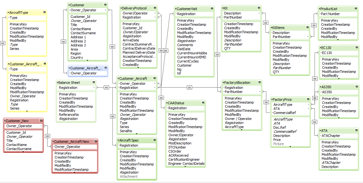

Most of my tables relate to a registration number which must be a text field. I did not select the ID if the aircraft to be my key throughout the DB.
and on the layout side, when using the balance sheet as related record, I dont have Customer_Aircraft in the list either.
Maybe, my relationship table will give clarity for my reason to Registration as a key.
Could this be part of my problem i am having?
Edited by Gismo12
You should not use registration as a key if it's a value that you have no control over and if it is not unique.
I see many relationships in your system that are questionable:
  • You're relating Kit>KitItems by Description! Should be by KitId
  • ATAChapter? Is that a field you control?
You didn't answer where Registration is created. By your system? What is it? (auto-enter serial?). Why do you have a PrimaryKey field if you don't use it for relationships?
Also, before you go much further, I would strongly suggest adopting a convention for the Relationship Graph. I prefer Anchor-Buoy, but you need to do something. This will not scale well.

Let's see your new relationship graph after you refactor the relationships. Also, why do you name the Aircraft table Customer_Aircraft? I find that confusing. It sounds like a join table, storing data about the many aircraft a customer owns and attributes of that ownership. I'd change that table to simply, Aircraft.
Please study up on Anchor-Buoy!

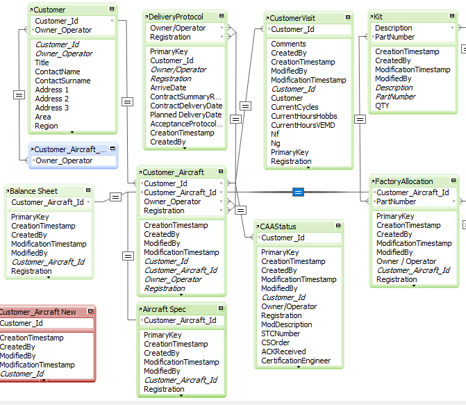

Below is my new relationship with ID's

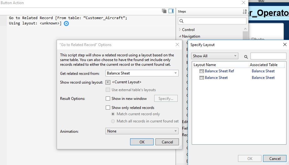

I still can not see my Customer_Aicraft tbl in Show current record using layout when I select Balance sheet  as get related record from.
So, a customer can have many Aircraft?
If Customer>Customer_AirCraft<Aircraft Spec is true, then you should have two foreign keys in Customer_Aircraft: the CustomerId and the AircraftId.
What is the primary key in the Aircraft_Spec table? That should be what relates from Aircraft_Spec>Customer_AirCraft.

Customer_Aircraft Layout has 2 primary keys, Customer ID which record the customer and the Customer_Aircraft ID which refers to the Aircraft ID.
So when I write the script to open the Balance sheet and show records from the Customer_Aircraft layout, this layout is not available in the list to select. It only gives me the option of Balance sheet and balance sheet Re

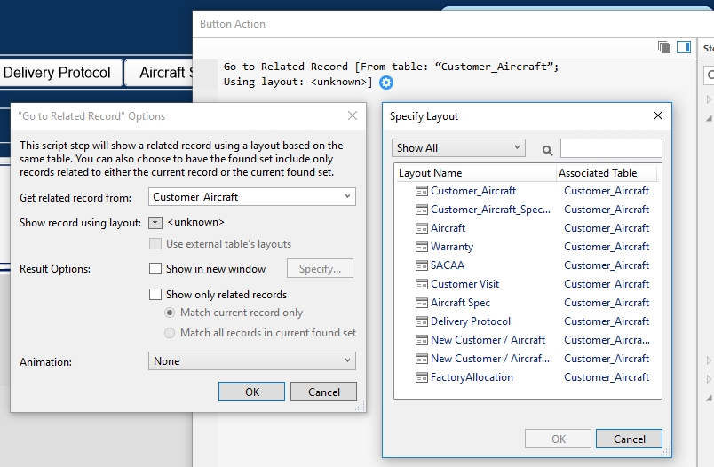

Any proposals for above request? would really appreciate it as I just dont know which way to go from here. My Customer_Aircraft layout is not available when usen the Balance sheet as related record

The Customer_Aircraft layout  is not available because it is not a layout of the same base table as Balance sheet.
Every layout is defined to show records from a specific table occurrence on your relationships graph. And every table occurrence on your relationships graph belongs to one of the base tables defined in your file under the Tables tab. When you want to go to related record from a specific table occurrence, only layouts belonging to table occurrences of the same base table are available.
Oh okay now I understand.
So when I am on a certain layout and I want to open a different layout but go to the same customer, how do I accomplish this?
Ah, sorry guys, found the solution.
I was trying to open a layout from different tables references
